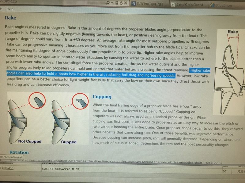

                Perhaps these images help.

                          Originally posted by Fluid
                          While "bow lift" is how full-scale props are described, not so with models. High lift means transom lift, it's been that way for decades going back to Tom P at Octura. Right or wrong, to bring in the term "bow lift" with model props now just confuses folks and is best forgotten.
                          Really everyone was under this same impression that when lift was talked about,, it meant bow lift !! The older boats used straight steel shaft and were not designed for flex shafts there for needing stern lift to keep there ride level !
                            I'll agree with Jay and Darin here. What you refer to as "bow lift" is actually a lack of lift. Your twin cat example is a good one to note. Reverse direction of the props and watch how it changes the lift characteristics of the boat. This will change whether you see the bow or transom lift in your run, but to what degree will be relative to the overall amount of prop lift.
                            Whatever you say.....
                            • Darin Jordan
                              • 8335
                              WHY do you think it's "holding the bow higher in the air"?? Think about it.
                              Darin E. Jordan - Renton, WA
