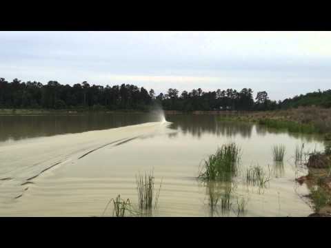

        Good info. I'm a little nervous about changing things up. The last mono I built did 91 but it did porpoise a little on the top end past 90. See if you can tell in this video. Trying to eliminate it.

              Looking at the video, can you tell what it's doing? The nose is raising and lowering. I need to figure out to stop that, I'm basically building the new boat almost identical because I know the first one worked well....just gotta refine it a touch more. The bracket I'm using is the 2" strut bracket. Should I move the prop a 1/2" closer or leave that part alone and move the batts up a little? This one will have a little more weight in the nose tho....

                      From my point of view, i think that the air flow going under the hull is making it porpoise. The boat is almost running only on prop, so i say aerodynamic problem.
