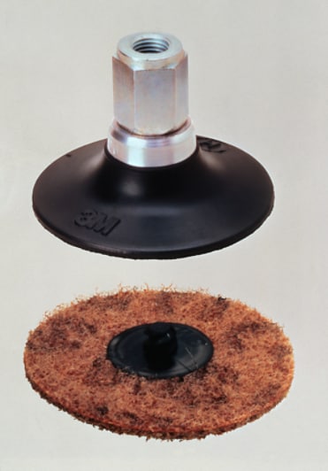

                        MY favorite prop tool is a right angle air grinder with various rotoloc pads. I can whip out a prop pretty fast with it but like others have said wear a real good mask with some eye protection. I don't do as great of a job making them look real pretty but my props seem to work good on the water so I must be doing something right after 20 something years of RC boating.
                              http://multimedia.3m.com/mws/mediawe...6EVs6E666666--
                              I agree with all of this 100%.
                              If I want to make a prop look pretty I can take my time, but more often I just want to get them cut/shaped/balanced and on the boat for testing.
