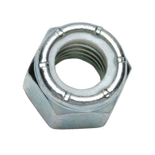

    i use nylon lock nuts on mine havnt had one come loose yet

          Whatever sort of locknut you use, make sure you use a new one every few times you move it, they all loosen up with use.

            Simple nuts with the nylon or teflon and keep putting fresh ones every so often. I bought some at lowes and also got some at a hobby shop. I just looked, steve has some kind of locking nut but not the ones with nylon that I could find, they maybe someplace on his pages.
            I worked hard on that prop...put nylon nuts on it...... hehehe

              Good answer, especially with the nylocks. They should be replaced every few uses. The metal ones are an interference fit and should be replaced every time they are taken off.
