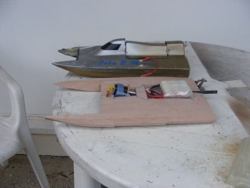

      My Oncilla 430mm cat for mini hydro currently running on 3s1p 2300mAh A123, Mega 16/15/2, Castle Pheonix35, 1mm wiredrive, X427 with about 3/5ths its original blade area.
      For reference the European Mini Mono, Mini Hydro, Mini Cat(where existent) and Mini ECO(the only Mini class which has been adopted by Naviga and gone worldwide at the moment) classes are all for hulls of 450mm and under(around 18") so there a decent and growing number of hulls in this size range.
      Not the prettiest boat ever but function over form, the cockpit is that shape to fit the gear in and it does only just fit.
      No room for or need for velcro to hold the battery in, it hasn't got anywhere to go, what you cant see here is the motor and servo, the servo is hidden in the tailpipe, although it has since been relocated to the starboard sponson.
      The motor sits up front in the cockpit to maintain CoG and keep the bend on the wire to a minimum. Seen next to the battered and abused old 448mm Firecrest which it replaced, designed for a lot less weight and a higher top speed the sponsons are a lot narrower and there is much less tunnel lift.
      First time in the water and she does float, Just.
      Running in Mini Hydro at the nats, different rules to my local series so running 2s 1800mAh 30C Kokam pack here on stock X431, I may make a slightly smaller but much prettier one for LiPo at some point.

          From memory the CoG is at about 40% now, was 30% in that photo of its first wetting with its arse under water, but it was too flighty there.
          No similar boats, I believe I am the only one racing cats in Mini Hydro, I know I'm not the only one that has a mini cat but most are the scale type that are too narrow to compete with a rigger for ovals, although I have heard rumors that someone has made a self-righting F1 cat for this season. No close up pics sorry, I'm running on a crappy copy of windows without any service packs and Linux at the moment and neither will recognise my USB2 external had drives. Our first race of the season is on sunday assumeng my car makes it there, which is not a foregone conclusion at the moment, I will take some close ups of the mini classes for you, no action shots as I should be running. till then best I can do you is this closer shot of the Oncilla and a mini rigger.
          Theres a thread about my Oncilla here if your interested have a look, if your really interested I have the WoF templates on paper, we may be able to come to an arangement.

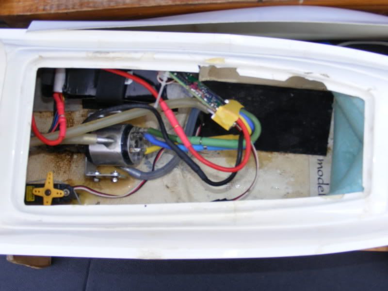

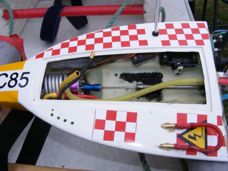

                  Yeah I made it, got the car fixed on Saturday, but my brain and my battery box didnt make it so the race didnt go for me, I did stay to do dutys and take some pics though. the wind was blowing in the worst possible direction and it was rougher than I have ever seen that lake before with breaking waves on the course, and conciquentially the micro classes were not very well supported we combined the classes to get a race but had only 4 starters, 3x mini monos and 1x mini ECO all selfrighting, after seeing the first heat I wasnt to disapointed about not being able to run, I dont think my Oncilla would have stood a chance.

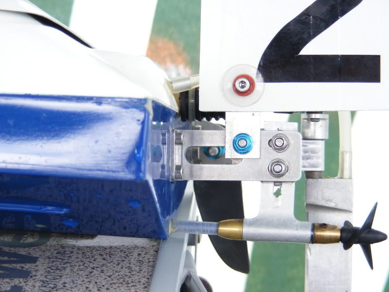

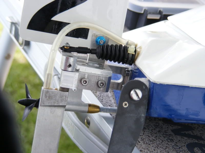

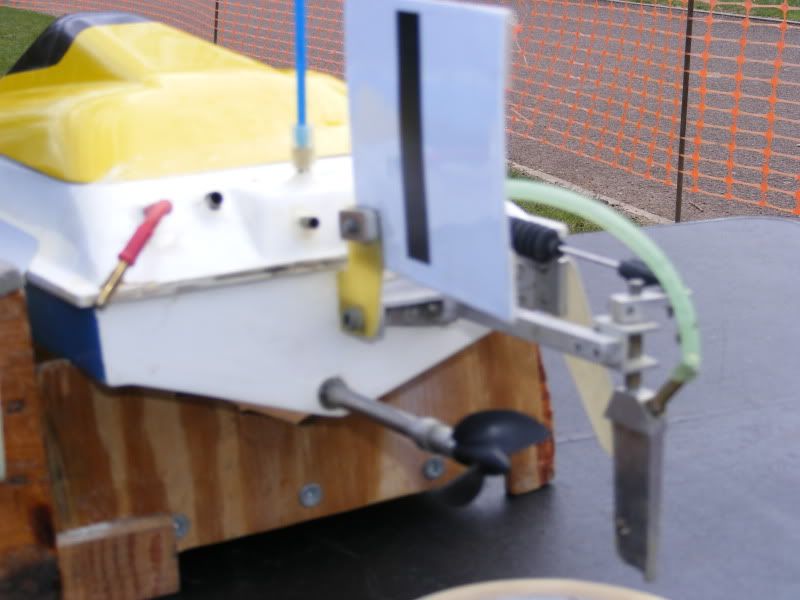

                  Here are the close up Pics:-
                  H&m Redbird, Feigao 380 10s, 2s 2100 thunderpower LiPo.

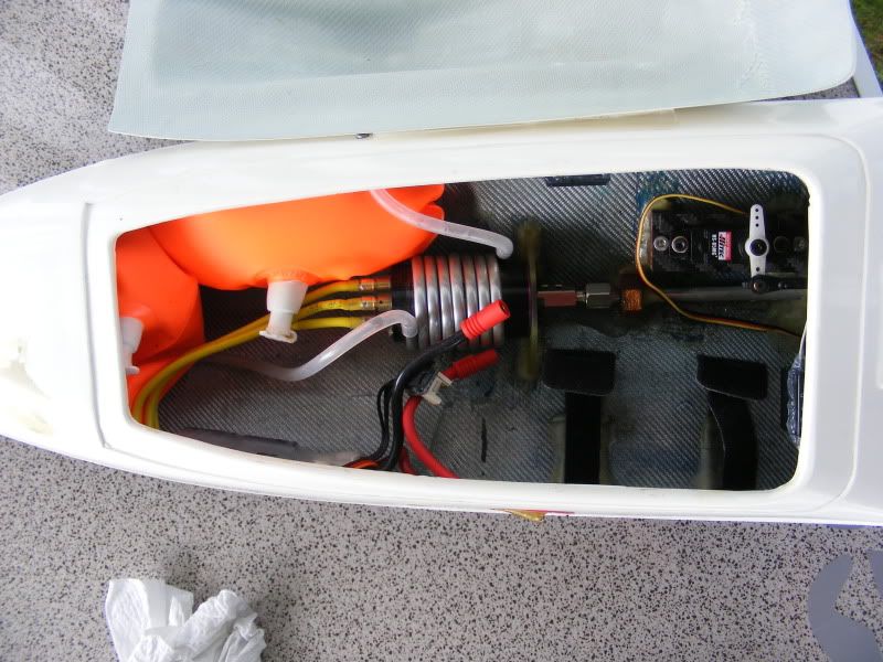

                  • NativePaul
                    Greased Weasel
                    • Feb 2008
                    • 2760

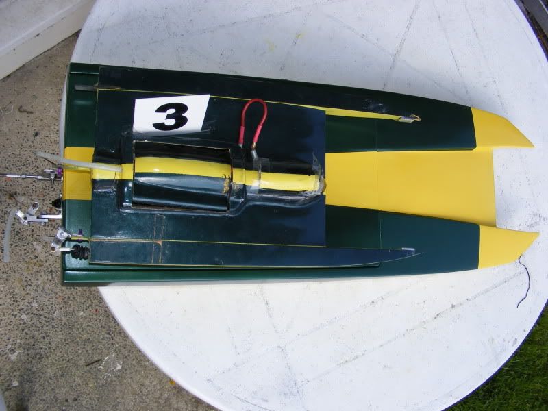

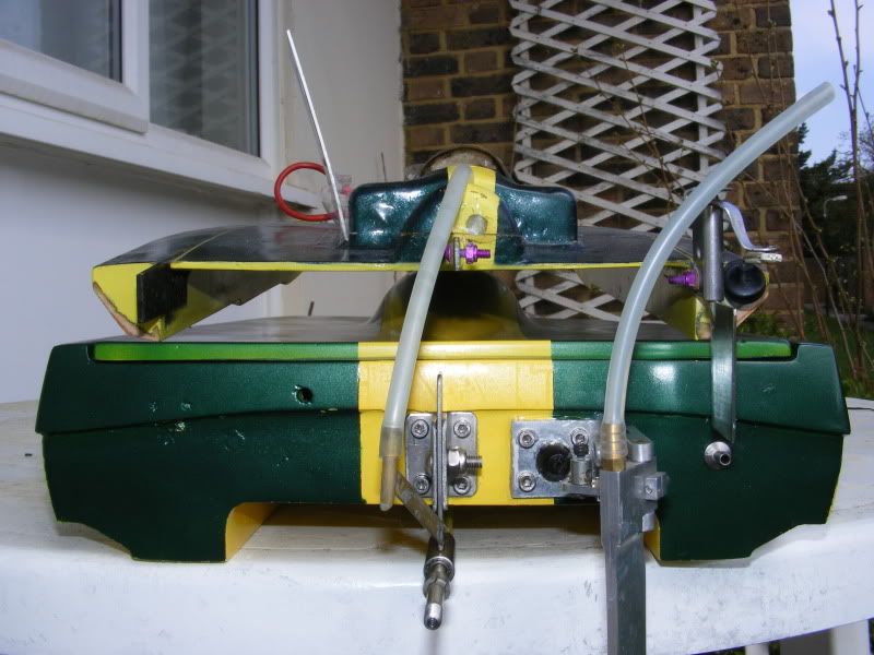

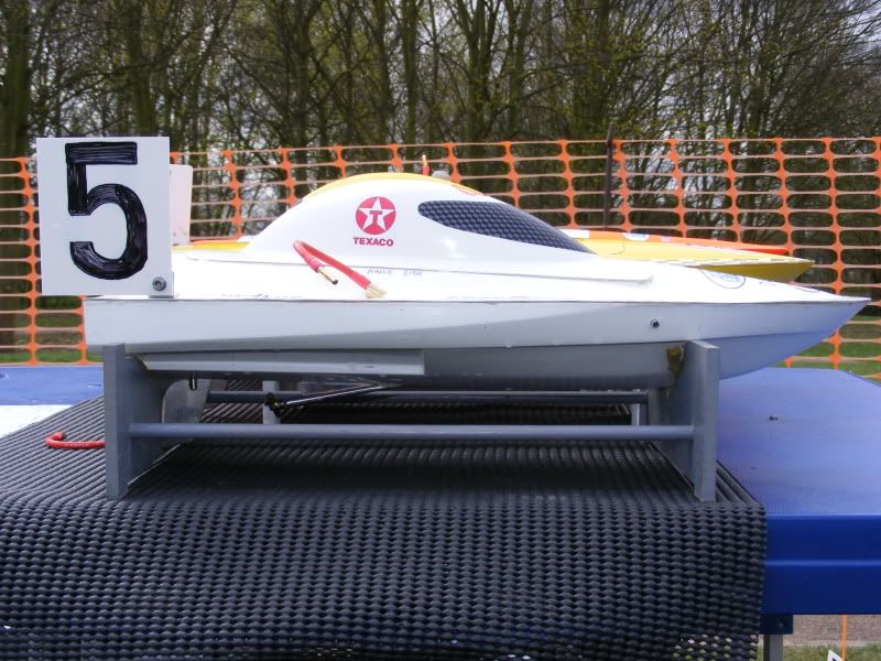

                    #69
                    Modified ToysPort Joker family, mini in the forground cut into 13 peices, some discarded and joined back together to make it under 450mm and narrower than the origional, standard in the middle, and large at the backwith bits of 3 boats grafted togeather for rough weather, the mini has a lehner 15 series, cant remember which one. on 2s LiPo.

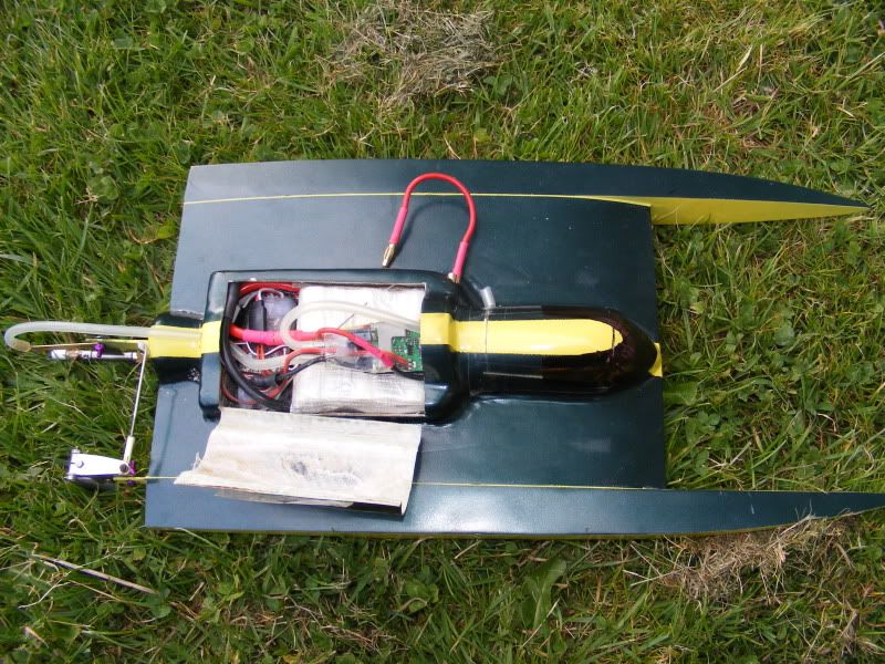

                      #70

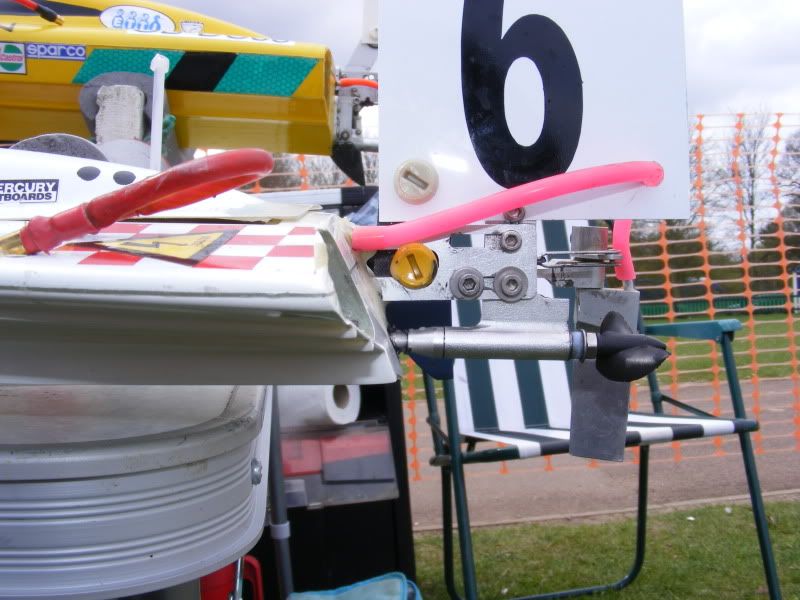

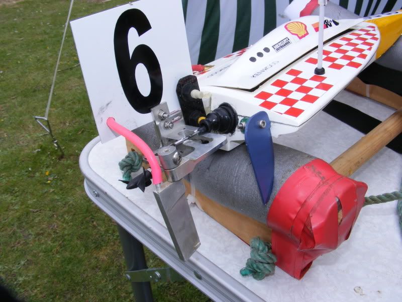

                      Eagle. cant recall who makes this on but its an old Mono1 hull from brushed daysthat at under 450mm is was too small for the Current Mono1, theres a few old hulls like these and my Firecrest coming out of retirement with the new Mini class power here is a Lehner 15series on 2s LiPo.
                      • NativePaul
                        Greased Weasel
                        • Feb 2008
                        • 2760

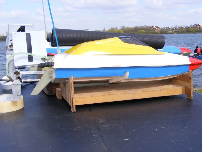

                        #71
                        Another Eagle, this time powered by a Mega 16/15/4 and 39mm prop, I forgot to ask what the LiPo was but from the low KV I would guess 3s (Electra my local race series, has a 43v maximum voltage limit for all classes and restricts power with a pack weight limit)
