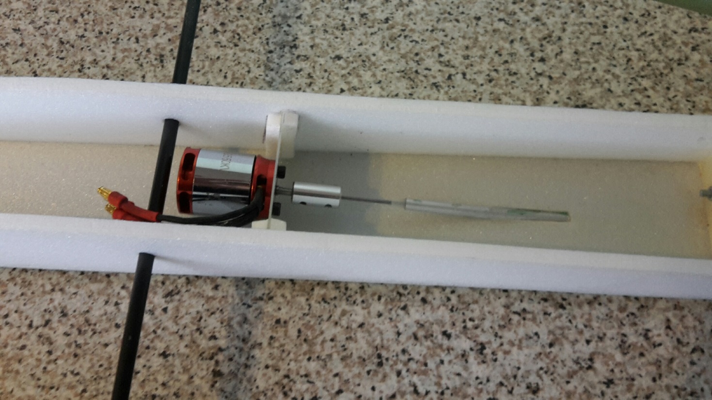

      No fancy motorization for me this time. Just a cheap and old Turnigy H2218-3550kV outrunner. The Depron-construction will make it fast, mind my words:

              • 96
              Actually, it is complete Depron. 3mm for bottom of the tub (i.e. middle section), 6mm for the rest. The floaters' underside are covered with 0.5mm GFK plate, as is the ridepad around the axle. Glue: UHU POR (tacky-kind of glue, works wonders if used according to specs). Rudder is 0.8 GFK plate and a little carbon-plate (but 0.8mm GFK-plate is perfectly fine).
