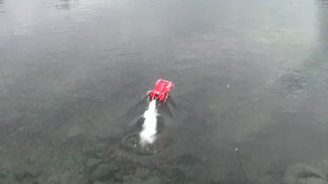

                            Here is a short video. It shows how it flips in the turns.
                            • JimClark
                              • 5907
                              hw much servo travel do you have set up plus you are taking a very tight turn
