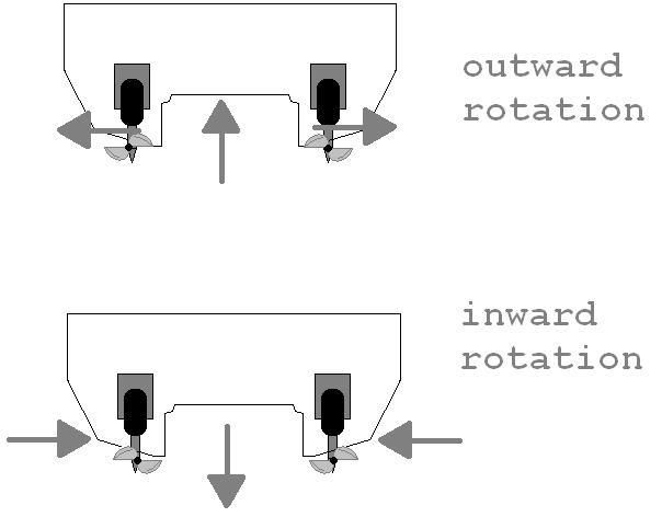

    Just for fun, I re-powered my scale Coast Guard boat with some Titan brushed motors I had left over from the Twinstorm days. The stock wimpy motors turned some wimpy props [ picture]. I want to re-prop and I'd like to know if there's any advantage to install counter-rotating props, and if so, to rotate inward or outward ? The boat has a forward & reverse SC if that matters to the setup. There's a nice selection of eligible props right here, so any input would be well received !

    Bonewar reports that cats turn better with props that rotate inward (clockwise on the left). I have found this to be true but have not tested other combinations. You may not have pronounced problems without a huge thrust cone like Bonewar and the twin cat brigade.

      The general rule in scale boating is:
      Inward (as Jesse describes) for speed
      Outward for stability

        Thanks for the info. Will go with inward. Since the hull is a semi-displacement design & won't be going that fast it may not make a whole lot of diff, but I'll give inward a try.

          Inward will lift the stern...

                  counter rotating props, inward or outward, make a difference on surface piercing props but on fully submerged? not sure if there's any interrest?
