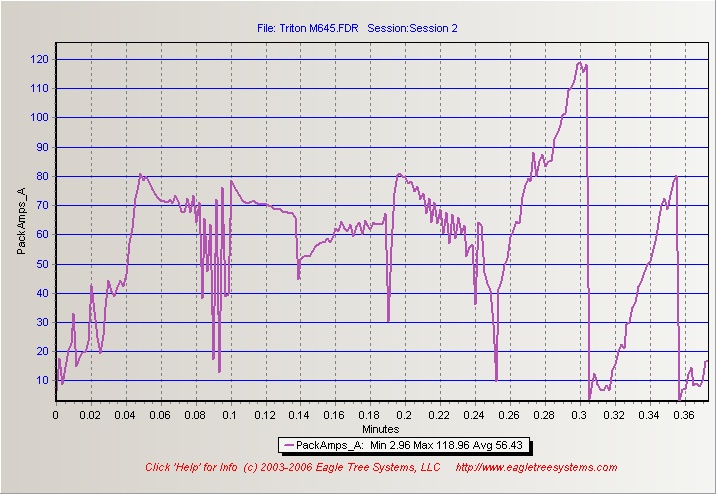

    I went to the M645 prop today on my Triton, it gps'd at 48 mph. Averaging 56 amps. I love that eagle data recorder!Too short a run though, had a pretty violent wipeout! I think I have some adjusting to do in terms of cog and strut angle. Too bad it pulled the trans loose after that run, I'm sure the devcon will hold it down in the future. It's now my fastest boat, I hope I figure out a way to keep it on the water! Here's a vid and the amp graph data from the run.

              That low amp draw average is great! Im pulling that with a 700 at a fraction of the speed lol. As far as the "get together" Im all for it, its a damn shame were all so far away from each other..

                      Looking at the graph your actual running amp draw was somewhat higher than 56 amps - that must be to average of all the time you were running. Without seeing a throttle or speed graph to compare with the amp draw, it appears that when actually running your amp draw was a lot closer to 70 amps - still not too bad.
