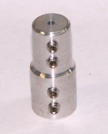

    OK... I KNOW there is a way to get these stinking 5mm to .078" set-screw style couplers to work... but after loosing THREE different shafts... AND the props associated with said shafts... I'm ready to throw them in the dumpster and find something better...
    I KNOW, however, that people have success with these things, so if you don't mind, could someone please tell me HOW they do it? I KNOW that I had the set-screws as tight as I could get them.. and yet... the shafts just keep falling out the back. WHAT could be the deal? Am I suppose to put "flats" on the wire? I'm getting REALLY tired of losing props...

            Doesn't help... They are his couplers and wire-drives I'm using... I have to be doing SOMETHING wrong... because there is NO WAY these set screws... on TWO separate couplers... weren't tight... The second coupler was one of the newer ones with the higher tolerance wire-drive hole... and I assure you it was as tight as one could get it...

                I use the .078 from Jeff too. Grind a small flat on one side of the wire, it WILL hold. Until I cut a flat spot, I had the same trouble.

                    Darin, sorry to hear about the loss in drives...that really sucks! A flat spot is the key. Also, some couplers that even I have made (set screw style) must be checked well. I have found that even with mine if I do not really check the set screw threading to make sure they actually go to the wire then they feel tight but are not. It fakes you out and you think it is tight...but it is because threads are not all the way thru the coupler.
                    So I make a slight flat spot and put the wire in and slightly tighten to find that flat. Or even easier is to make a mark on the wire drive where the flat is and then set them down. The opposing set screws are to push the wire to the flat as well. This way it is not putting pressure on the alum coupler but holds the opposing side with steel...if not the alum will wear and the set screws will not hold it. I have never had one slip in my boats or the 100s I have sold...or at least they have not written back to tell me. Also thread locker is a must.
                    The smaller the coupler (062 and 78) is the hardest to make. Big couplers are easy to make.
                    As of now I am modifying the Octura version but some new 078 versions are on the way. What is the one you mention about the high tolererance hole you stated? You have never gotten anything from me as far as couplers.
                    They are tight so when you get them I take my grinder or wheel and make taper point on the wire so it will push in. You actually have to twist using your prop to twist them in but once tightened...they are solid.
                    I can assure you the set screw style does not slip unless whomever is making the couplers are not threading them well enough.

                        Here's the deal... on the first set of couplers I purchased... One went in my Miss Oberto, and the other in my DeWalt... The Oberto has never dropped a shaft while I owned it... The DeWalt during it's second test run...
                        When I got the DeWalt home that day... I took the coupler out... and, after resisting the urge to beat it to death with a hammer, I looked it over and let reason and logic set it...
                        I ran a tap through the 4-existing set screw holes to make sure they were tapped all the way through... THEN, I drilled another pair of set-screw holes at 90-degrees from the existing 4, giving me a total of 6 set screws... All tapped all the way through and and having verified through visual inspection that the screws were extending into the hole plenty far to grip the wire...
                        THIS is the coupler that let go this weekend... RIGHT after I had verified that all of the screws were very tight...
                        I then switched to a newer coupler from OSE, which Steven told me had been improved from the first set by a tighter tolerance on the .078 hole... it's VERY snug...
                        Two laps in... this one let go...
                        SO, my only conclusion at this point is that I need to put flats on the wire to make this style of coupler work for me. I haven't been doing that, and now, 3-shafts and 3-props down, I think that's what I need to do... I still don't understand how 4 or even SIX set screws wouldn't be enough to hold that round wire in place... but I'll give the flats a try and see if that helps...
                        Honestly, I REALLY HATE this style coupler... it's a pain to deal with... BUT, I do know that they are truer than the Octura style... I can see that on the bench and I'm sure that can make a difference in how long the system holds up...
                        I'll give it another try... but I may figure out a way to put in a wheel collar in the system to prevent the shaft from falling out, coupler or not... Just to be safe!

                              Can't really do any more than you have except for the flat spot. That is plenty of set screws to hold it. Do you lock tight the set screws?
                              Sorry to hear about it. Yes, you can get a 1/16" collar wheel and drill it to 78 and use that at the stuffing tube/coupler in case it would let go. Not sure about balance on something like that but it was used in straight hard shafts long ago.
                              I will have more modified Octuras shortly and yours will go out.
