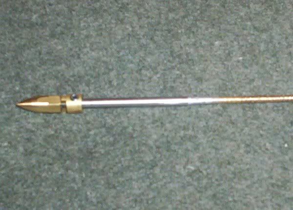

        I decided to go with the solder method. I dug out my old and I do mean old heavy duty soldering iron, the kind not used for electronic work. I tinned the end of the cable then filled the hole in the stub shaft with solder the sweated the two together then dressed up the joint. Thank you for all the comments.... Harold
        • pzrwest
          • Jan 2009
          • 27
          Here's a pic of the solder joint. Need a better camera to get better pics
