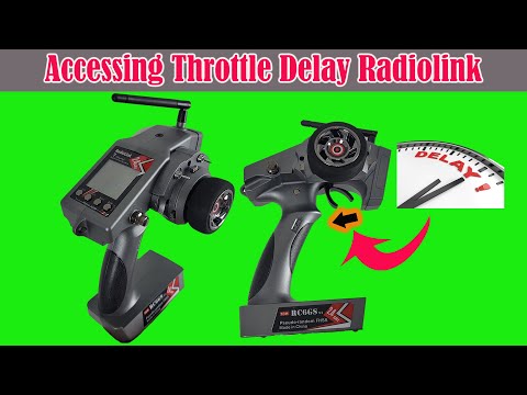

                my $70 radiolink does this built in on top of throttle exponential. It also out performs my Airtronics in range. I prefer it over my Futaba for my planes as well.
                they also have telemetry capable receivers for $22 so you can display your battery voltage on the radio. as well it has active FPI where your head not only can control the camera gimble it can control the throttle and steering servo and turn the boat, car, etc by moving your head up/down or left/right. pretty neat radios for the money. They do feel a tad cheap though in your hand. and I hate the antenna that just sticks out and will be easy to break.

                  I did not know about this radio. Looks awesome for the price point, I will check it out. Oh man I would have epic crashes controlling something with my head lol, that's pretty dang cool though. Thanks for sharing. Are those throttle delay functions the same as the THR (Throttle Speed) and TH ACC (Throttle Acceleration) functions on the Futaba 4PM? That's what it looks like to me anyway. I have seen a few radios with similar functions. But like the RC Explained guy says in that video, the limiting factor is the time delay; 2 seconds from 0-100% throttle is still too aggressive for the speed run cars. I know I have to drag out my acceleration time longer than that with my twin cat to avoid unsettling the boat. I'm guessing this is why the Perfect Pass module has a place in the market, it can really drag that out to what looks like 5-6 seconds or so, and probably more if used in conjunction with the radios built in features (not that you would want that long of a ramp time). If I had to guess, I probably average around a 3-4 second ramp time for a nice smooth and planted acceleration with my explorer in particular.

                    im having the same problem with my single cat with a 56mm motor. I simply cannot apply power slow enough. I have the throttle speed on 10/100. Im thinking my -80 throttle exponents are making the top of the ramp-in too aggressive. Just turn exponent off entirely and make it linear with throttle speed on 0-5 or so. The thing literally spun off the top layer of a new 1/4 flex shaft.
