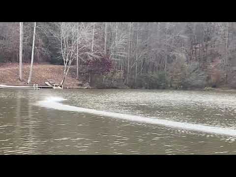

                    As requested a couple videos of testing various JAE riggers:
                    Mini Twin:
                    Tyler Garrard

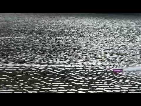

                    • RaceMechaniX
                      • Sep 2007
                      • 2833
                      JAE 21 FE Twin:
                      Tyler Garrard
                      NAMBA 639/IMPBA 20525
                      T-Hydro @ 142.94mph former WR

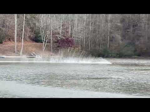

                      • RaceMechaniX
                        • Sep 2007
                        • 2833
                        Single Mini:
                        Tyler Garrard
