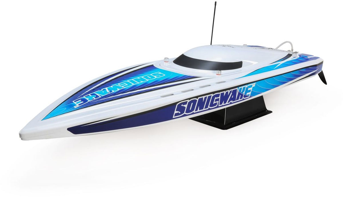

          36 inch self righting Proboat Sonicwake Version 2 it can handle some chop and is a great boat right out of the box. I've been having a blast with mine all summer long.

                        I have both versions and find the V2 to be a much better designed boat and handles a lot better so hold out for the V2. Also do not be turned off by the plastic hull as it is very robust and has an internal reinforcing skeleton so it can withstand some punishment.

                            The Sonicwakes have been my first experience with ProBoat and I do a lot of research on the boat forums before making a purchase. I started with the Aquacraft Revolt 30 about 8 years ago and then progressed to upgraded old school TFL Pursuits and a TFLRocket. Both are excellent boats if you are willing to make some modifications. I was seriously considering the new impulse but from videos I have seen it seems to be unstable and many forum members complained about the hull taking on water. Given my experience over the years I think the Sonikwaqke V2 is the sweet spot for ProBoat. That is why the are out of stock but Horizon hobby should have them by the end of the month. I like it so much I am even considering getting a second one.

                              So the Sonicwake I just purchased used for my son on this forum arrived today. It's big. The previous owner upgraded many things so I think it's nearly on par with the V2; maybe a few things are better on this one- motor and esc? It doesn't have the grid glued to the hull like the V2. Being an engineer... I disassembled EVERYTHING tonight. LOL I'll clean her up, realign the shaft/motor, waterproof everything with corrosion x, lube the bearings, etc...
                              I don't know how she will run but I'll let you know.
                              I own the new Impulse 32 and have been running her all summer. The common issue is it leaks water from the water jacket. It's because the rear motor clamp goes around the cooling jacket instead of around the motor. Tighten the clamp too tight and it flexes the top of the jacket o-ring, pulls the jacket off center of the motor body, creating a gap between the motor and jacket at the bottom (6:00 position). Loosen that clamp and no issues at all. Mine runs dry now; it leaked initially.
                              Mine is now stable. Yes, it was unstable at first but a few adjustments and no problems. I angled the stinger down a bit (just slightly so the flex shaft would slide in easily and not make much of a bend. I like three blade props so that's what I use. Then adjusted the tabs downward until she ran perfectly. Only ever ran on 6s.
