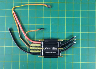

        ZTW 150A High Voltage, perfect if you want to try 8S

          Thanks to all for the replies . to answer fweasel mostly sport running with a possibility of racing or saw down the road. I guess for now i will use my Swordfish 220 amp pro + esc . Regards Andris Golts.
