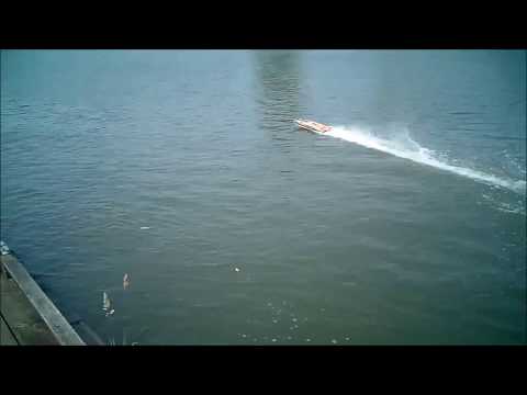

                          Alright,
                          I did some upgrades to my Genesis. I installed a new TP 4060 Motor 1650Kv 6D wind, and a Seaking 180A ESC. I also made the battery trays longer, giving me more adjustment to the rear. I'm running this setup on 6s, but am disappointed with the results. While the boat is quite fast and has great acceleration, I still feel that the hull runs too wet. I have not once had to worry about the hull flipping from running too dry. I have had the strut at a raised position, I'd say about 3mm up, but maybe I've gone too far? On my last run I adjusted the strut angle so that the front of the prop pointed into the water more, and this made the hull run better, but still wetter than it should run. I've been using Octura X445 and X645, and am planning on getting some ABC props next.
                          With the new motor and ESC, the hull currently weighs 111oz, and the center of weight is at 31.8% before batteries. I had to make my battery trays longer to put the weight farther back, and I feel like with the batteries in the back this thing should be trying to flip over? Anybody have advise for what I should try, or what I may be doing wrong. I admit that my batteries are not the best, and I'll need to get a higher C rated battery next, but I'm kinda lost at this point.
                          (not the best quality video)

                            still too wet, more positive trim, I had to file my strut to get enough adjustment
                            check your private messages..... I have a video I made to setup the genesis for another guy ..
                            hope it helps it should run with an attitude like this when you have enough positive trim... running an octura prop

                              ABC props have much less lift at the transom than the Octuras. Switching to a 17-45 series prop will dramatically improve your ride attitude situation. I run a 1915 prop on my 6S and 8S setups.
