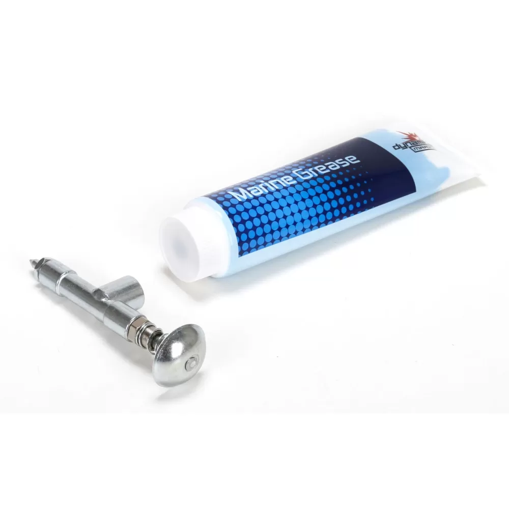

        Like Peter said, shove some grease into the stuffing tube after storing the wrapped up shaft to minimize water intrusion
        I use this, just perfect for that:
        https://www.offshoreelectrics.com/pr...od=hh-dyne4200
        (remember to flush your cooling lines too !)
