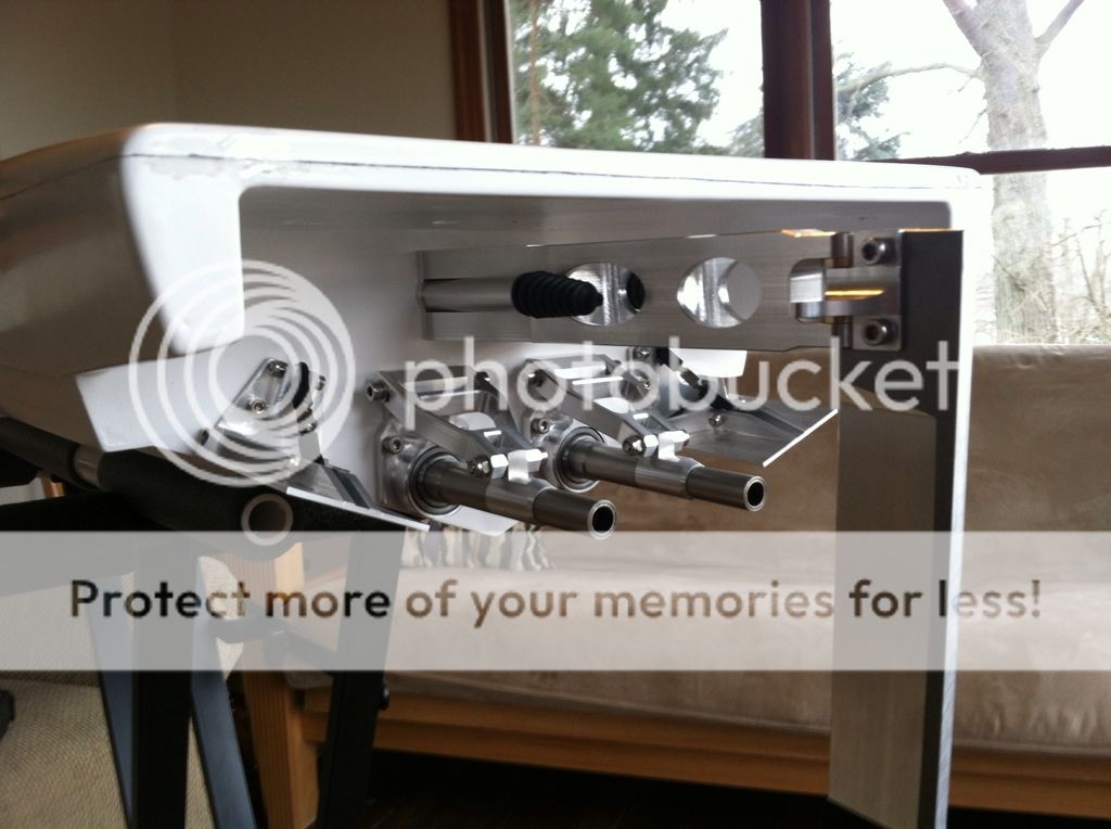

OK is there a rule to follow when doing twin out drives?
how far apart do the props need to be?

as long as the both blades are clear of each other when spinning plus counter rotate the props .

What propellers will you use ?
If you run 45mm propellers, distance between the stingers is 47 or 48mm

I really dont know what props im going to use yet. the boat is a 59" sv-43 almost identical to the boat pictured

I'm prototype my brackets so I'll have to space based on a large 70mm prop. With the 70mm mock up props I have about 8mm between props.
