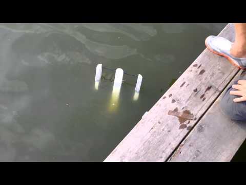

      Many of the latest Mini Hydros and Hydro 1s to come out are designed to allow self righting, the majority of them use a rear flood chamber to achieve it.
      I can't find a video if the Exe05 specifically, but here is an ETTI outcast which does it in the same way.
      Somthing NativePaul shared on a on a different thread.
