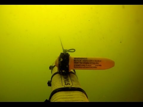

    Wonder if one or two of these little "getter back" devices attached to it would be up to the task of pulling it back to surface? I have had a couple for a few years but never really thought about using them for my rc boats or even just a hatch. Here is the link for who can't see the video below in internet explorer https://www.youtube.com/watch?v=ks8eWyZKMDo

      Attaching it to the inside of the hatch would only be good if the boat flooded inside or the hatch came off.
      If the hull was stuck in the mud and water got inside to set off the float. When the float came up you would only pull the hatch off and up.
      If it takes 12 minutes of being under water, why not attach it to the main hull.

        That's what I was thinking of doing was just attach it to the rudder or someplace similiar. I was also thinking of just attaching it to a hatch so if it were to blow off like on my MC. Supposedly the check valve won't release until it's under the pressure of 10ft water after its been submerged for at least 10 minutes.

          so this unit won,t work unless its under about 10 foot of water plus submerged for the 10 minutes. use pool noodle floaties.

              Finding a sunken item is 99% of the battle. If it's too far down for you, a diver is $50-75/hr possibly plus transport/etc. At the least it would pay for a recovered motor & ESC. A specialist searching silt for a few hours is a lot more expensive. It can't weigh much so maybe just attach it to the rudder boom.
              From what I gather, it's just a lidded cylinder with something like baking soda & citric acid (alka seltzer) and a weak check valve. Anyone here could make their own small streamlined "blister" version that gets taped/glued to the top of the hull. Another option is just attaching a ball w/velcro & string that will tear off in a bad crash.

                  I bet you are right on the baking soda being the secret ingredient creating the c02 gas that blows off the top.
                  Ping pong ball on same kevlar line taped with scoth tape. The tape isn't water proof and might take a some time to pop off oor it may get pulled off in process of submerging. The ball and line could possibly pose a hazard for oval racing.
                  The only thing I would wonder about with this method is where and how would you put the line (50-100ft length) so it wouldn't just tangle up when the tape released the ball. It would probably have to be on a spool of some sort so the ball could get a clean release when the tape let go in order for it to make to the surface. The GetterBack float has the line coiled up inside on a cone shaped spool so it would be difficult for it to tangle up once it is deployed. Below is a good video showing some deep under water releases in different configurations and a good thread explaining it better as well.
