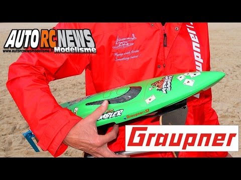

    Graupner Midnight Gambler v2.0
    30" mono hull with flood chamber
    3750kv inrunner w/o counter weight
    From the videos she appears to have no problems self-righting, how come?
    How could an Atomik Barbwire XL lose this feature?

              The midnight gambler fits the Mono1 rules, but is it is pretty low rent as can be expected from a mass market RTR, it is more commonly seen in a one design class which was fairly common at clubs in mainland Europe. The nearest thing I could compare it too is a SV27, although it was MUCH closer to a mono1 than a SV27 was to a P mono. Graupner have given a bunch of Midnight gamblers away to juniors and young spectators at the big races, and have helped a heck of a lot of people get into the sport, some of whom are now competing at the highest level. I have heard nothing similar of them since Graupner had their hiatus a cpuple of years ago and I would guess that financially they are no longer in a position to be as philanthropic, Neither Midnight Gambler has a second rudder or turn fin, and it would not be needed for oval racing, the mk1 was certainly not a marketing failure, it was one of the most popular race boats in Europe for a few years.
              With twin rudders and turn fins, or a central rudder and additional left turn fited it would turn left nearly as well as right (no boat with single prop will turn equally in both directions), but at the expense of not turning right so well. This one is optimised for ovals, but for those that didnt want to do ovals they had other boats like the Sonic Evo, that would accelerate ferociously and turn on a dime in either direction.

                  I don't know how the seller you saw it on chooses to market it, but on the Graupner site and sellers here in the UK are pretty explicit about it being a race boat; "Competition Racing Boat Midnight Gambler, Almost Ready to Run (ARTR) The "MIDNIGHT GAMBLER" racing boat is part of the Graupner/SJ "CHAMPIONSHIP-LINE" series. The "CHAMPIONSHIP-LINE" stands for top quality, including for use in competitions." The marketing video embedded in the graupner midnight gambler page shows a bunch of them all running right turns around a course marked with buoys.
                  You might think it is worse than it really is from what Martin said, they are certainly optimised for right turns, but it is not like they cant turn left at all,you can see in the Graupner video above that some gentle left turns are possible at full speed for course correction, and in the following video they are turning left a lot, just slowing down before turning, whereas if they turned right they wouldn't have to.
