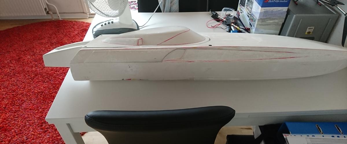

Hull 3650 g...The strut he bought is with 3,2mm flex..
I surgested 15-20.000 rpm and a 50 mm prop and about 30 mph..But I do not really know how a 3,2mm flex will work in an almost 8 pound,(emty) boat. The 2 times I ever used that size was in small 2-3 pounders.
Anyone who has any experience "with the combination" ?
