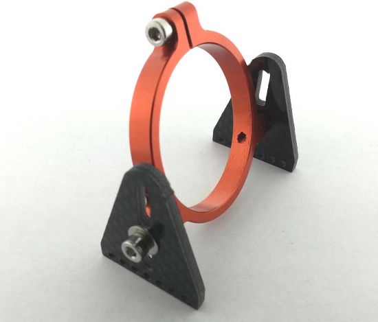

      There is the opportunity for someone to make a rear motor support that helps prevent the motors from shifting.

        Could just use something like this if there is enough room
          I put tp 4050 2050kv motors in mine. Jb welded the mounts in place. No issues yet. Goes 65mph on 4s.
