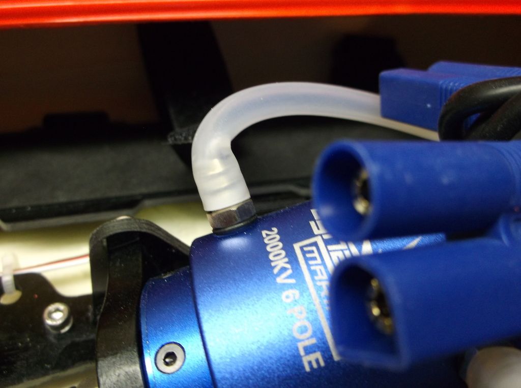

    so this is my first f/g boat . couldn't resist , my local hobbytown is going out of business and i got this with deep savings .
    what do i need to know about this boat?
    i read about changing motor timing . any issues out the gate on 6s?
    the hatch doesnt sit flat ,its raised up a bit on the sides ,that normal? and the one cooling tube could be longer ,it has quite a bend in it .

            1st intermission in the hockey game, so I've got a few minutes...
            drill out the water inlet in the bottom of the rudder and brass barb at the top
            route cooling to ESC first, then to the bottom of the motor, then out the top.
            Rotate the motor cooling jacket so the top water outlet is as close to 12:00 as you can manage while still fitting cooling tube under the hatch
            Start with strut even with bottom of sponsons and level, I ended up with mine 3mm above the sponsons
            run 3S packs as far back in the trays as they go
            B&S x440/3 prop on 6S, 7.5* timing was a screamer and did 60 mph all day long
            use a 2 piece SS collet from Kintec or whoever, $10, stock one is crap
            I ran a Kintec upgraded flex and OSE upgraded strut
            there's a breakaway rudder bracket from Kintec available if you think you might need that at your lake

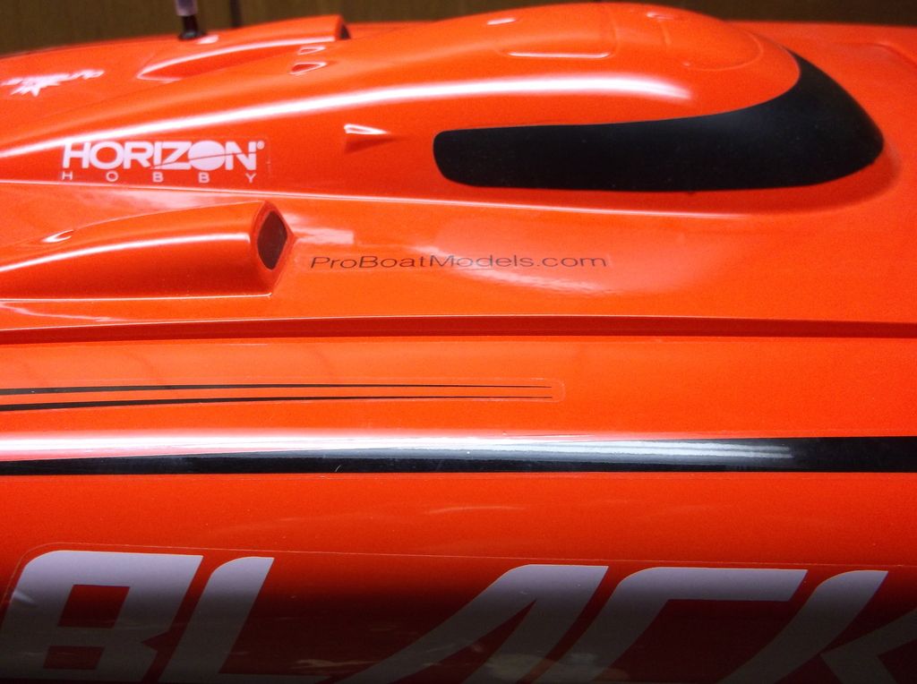

                      well horizon sent me out a new hatch in a hurry .props to horizon product support .
                      that said ,its not perfect ,sits better then the original but not perfect . and it has a paint flaw .
                      oh well , they tried ,i cant fault them . it might settle over time . they even sent me a roll of cooling line .

                        Honestly, I was reading your replay and was thinking how bad could the flaw be, but that's pretty nasty. The paint and shine on the V3 is so nice, shame to have it gacked right from the start. I would ring them again and get another replacement.

                          hmmmm......dont know if i have it in me ..lol.now the wife ...she be all over it..haha
