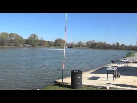

                  Some layout ideas. This is my MkII DF39". I run a Lehner 2280-1233kv on 6S2P 10,000mAh minimum. I find the key to the DF hulls is keep the CG fairly far in the back to keep the nose from bow steering in the turns. I would set yours up to allow some CG adjustment by means of shifting the batteries. I have tested the higher kv options with small props, but found the lower KV motors in the 1200kv range swinging larger props run better particularly in race water.
                  Here is what you can expect:

                      I would start with 2 blade props for your build. I run three blade props on mine with the 1233kv motor. I believe the prop in the video is a X460/3.

                          [ATTACH=CONFIG]148832[/ATTACH][ATTACH=CONFIG]148833[/ATTACH][ATTACH=CONFIG]148834[/ATTACH][ATTACH=CONFIG]148835[/ATTACH]
