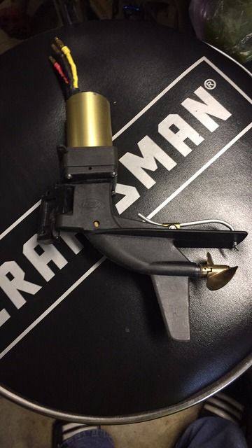

      Bear in mind..this boats name is "Butt Ugly" for a reason....still playing around with electronics layout...

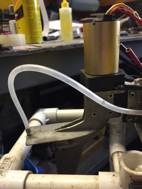

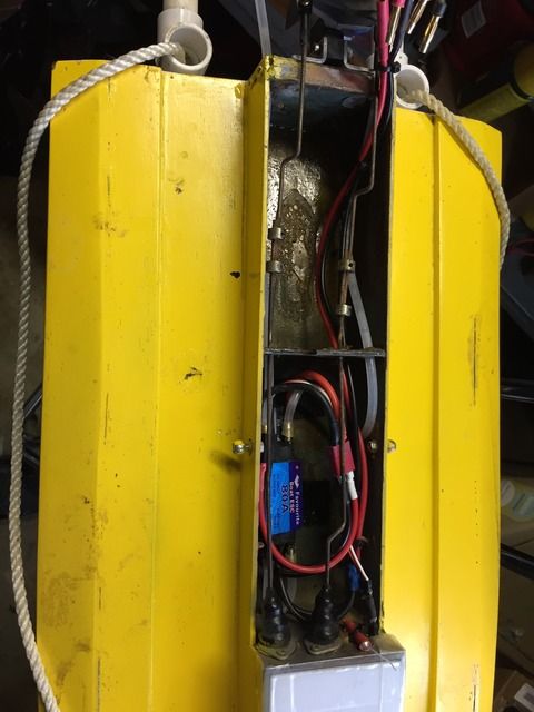

          This boat took a hella beating back in its day as a nitro racer as you can see........
          You'd be surprised as to what you can fit in there as far as electronics go.... I'm running a cheap 80amp esc with an old Electrifly Ammo 1800kv motor on 4s....speaking of batteries.......I'm able to cram a 5200mah 4s in the back, but its a bit heavy. I ran good today on a 2200mah 4s....until the flex shaft broke.....still trying to figure that one out!!!

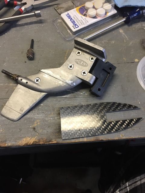

                Well...I picked up another flex shaft and got it in. While I was waiting for it to arrive, I did some research and found that a preferred prop for 1800/2030kv motors on an outboard is the Grimracer 42-55 2 blade. Found one on eBay for a deal so picked it up too....problem is, it's too big in dia to fit. It hits the bottom of my cavitation plate. So I think I'm gonna remove the plate and replace and raise it with a piece of carbon fiber. Probably won't be for a couple weeks for that tho....still have a mini rigger on the bench to finish!!!

                    Sometimes things just don't go as planned!!

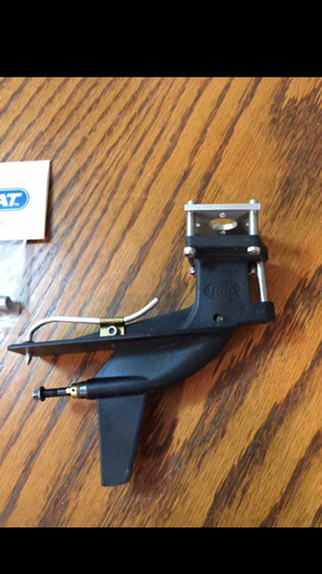

                    So here's what happened......I was trying to "nudge" my cavitation up just a hair to clear the bigger prop. using the good ole bench vise. Bad idea......I never knew thin cast aluminum would break so easy....no biggie...I planned on cutting it off anyway to move a new carbon fiber plate up just a bit. Well....that didn't work out either......I have no way to attach the new plate and still be able to split the lower leg in half for maintenance.
                    So.....I ened up buying a Rek lower to completely replace the old worn out K&B lower. Problem solved!!
                    Had to swap over a few parts from the old conversion, but overall its a huge success!!
                    I had no idea how worn out my K&B unit was until I got the Rek unit!!!!

                        With this REK unit, I can fit up to a 43mm prop. Currently, I'm running a detongued GrimRacer 42x55 with good results....the same prop wouldn't clear the cavitation plate on my K&B lower......
