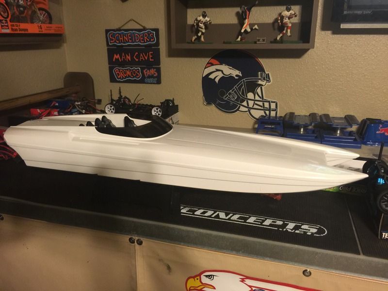

    Oh and cause everyone likes pics here is a pic of the hull.... Nice plane white, none of that 80's throwback graphic non-sense hahaha

            - I get it's a cheaper plastic hull, but figured for 140 I could deal with it....but come to find out that is just the hull, no canopy which is like 60more, and then I have to use all the proprietary Traxxas stuff and would be limmited to a 36mm motor can due to motor mount and I don't think I can find a 36mm motor that can handle 8s
            I think I may be canceling this hull order if I can(the pic is actually of my buddys hull) and getting a Genesis 1045mm single as I think it will be a better boat overall vs the M41 and provide me more options at a better price point.
