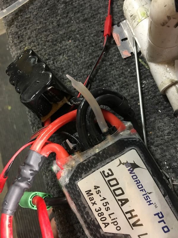

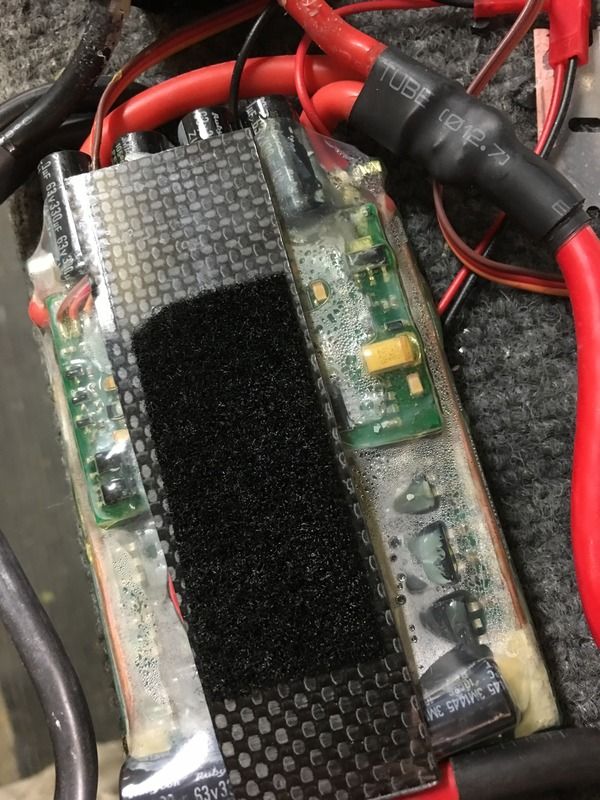

    Took the shocker ot for a spin this evening. Was just curious if my shorter rudder helped. Well it did. So much so that it busted my cooling hose loop at the front of the esc under the deck and put water in the boat and soaked the esc of course. Luckily I had epoxy coated it. He esc still works just fine.

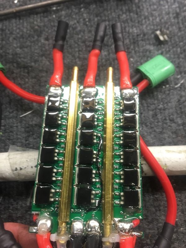

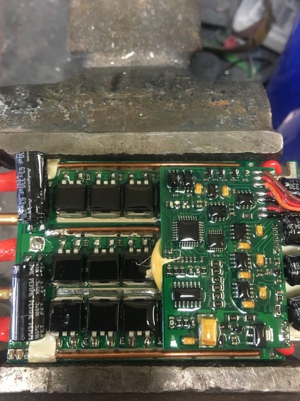

    And I took a pic a while back when i coated it. note, these escs come with a light half ass done coating on them. It had many bare spots on the circuit board

          This proces I do is super cheap and simple. I use 5 minute loctite eopxy I get from Walmart. I think it's $4 for the twin tube of it. $4 is not much to spend on a $300 esc for insurance. All I do is simply mix up some and then spread in on with a paint brush.
