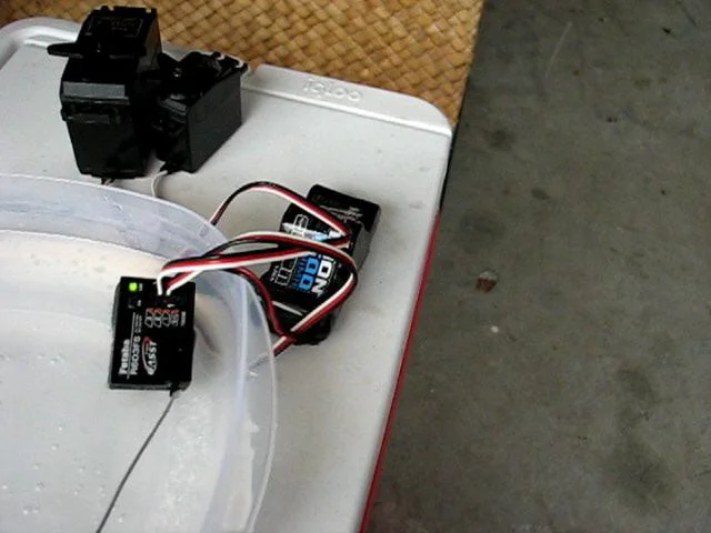

      Go with a Futaba Fasst waterproofed if you want dependable range beyond outa sight that works under water.
      Left this under for water submerged for 72 hours and it passed range check while still under the water with as much range as a brand new receiver that was used to compare to.

                • danielplace1962
                  • May 2010
                  • 91
                  #38
                  The receiver pins should not cause issues just being wet. Unless it is salt water or loaded with extremely high mineral levels the resistance of water is not low enough to even alter the 1500us servo center signal.
                  If your receiver is acting up when wet it is because the internal much more sensitive electronics are being affected by the water probably not the output pins.
                  A fully submerged properly waterproofed receiver will not do anything different under water even with all the pins submerged. Not even a wiggle or a glitch.

                          #42
                          Originally posted by Rafael_Lopez
                          I speak for our Spektrum receivers, when water falls in between the pins it shorts them out. You simply need to remove the connectors and blow out the water. They work good as new with the water displaced from the connectors/pins.
                          All water has minerals. Water is conductive. We cant change physics.
                          Thank god Futaba can.
                          Futaba doesn't glitch a hitch with wet output connections. It keeps the output at the specified pulse per second even when things such as high resistance water is in contact with the pins.
                          Check the video again. The servo's aren't glitching one iota. Rock solid. It soaked for 48 hours prior to the test. I put a weight on top and forgot about it. https://youtu.be/jC5INp1Wxxc
                          In my electronic ignition boat there is a servo extension connection going to the ignition unit that will shut down the ignition if there is a glitch in the channel 3 it is plugged into. Guess what ? that servo extension has it's plug outside the radio box and lays in the bottom of the boat and most often it is soaking wet if not submerged. Never has it shut down the ignition from a sensed glitch or signal loss. If it gets off the exact signal you have when you setup the ignition it will kill the engine. Never happened yet.
                          Could be another reason why Spectrum crashes boats.
                          If they don't just loose signal bone dry like they did with two brand new boats of mine both on maiden voyages (brand new 2.4 radio with 2 receivers first use on each ) in turn four on a tight course both lost signal and failsafes straight into the rocky bank and destroyed them one after the other in 10 minutes time with both antenna's fully up in separate tubes above the entire boat.
                          Futaba's haven't let me down once since.

                                I use these same receivers and used the liquid electrical tape with not the best results. Did everything but the pins. Daniel how do you waterproof these please.
                                https://vimeo.com/5670298
