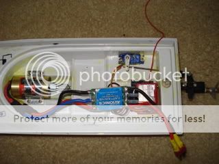

    well i finally finish my first brushless conversion and i love it. i got a mini-c about a month and a half ago liked the way it ran stock then say videos online of diegoboy's brushless one and had to do it myself. parts are as follows.
    motor: ammo 2845 2700kv
    esc: team orion captain 45
    battery: 11.1v 1320 mah 3s 20c thunder power
    prop: y430
    servo: 9g mini
    rx: hitec
    tx: aggressor srx
    drive line: stocks strudder with .098 flex
    so i ran it yesterday when i had a break in the rain and man this thing flys. i flipped it twice it was funny i didn't bring my fishin' pole i i got wet oh well. the only thing i think i nees to figure out is how to get it better ballanced. when at w.o.t. the boat list really really bad to the starboard side. should i put a turn fin on the other side to give it a little more drag or trim tabs or what? any ways enough with the talking here are some pics.

    i am going to try and talk my wife to come to the pond with me to film because i tried with one hand on the tx and the other on the camera and it was no good. i really need to get the port side down it is way up.

      Looks great! I'll keep an eye out for the video!

        so what do you guys suppose i do about the listing? turn fin? trim tab on the port side or what? i don't know i am still a newb when if comes to proper setup of a boat.
