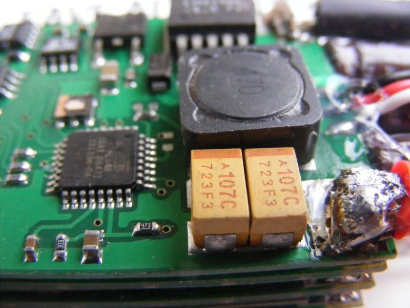

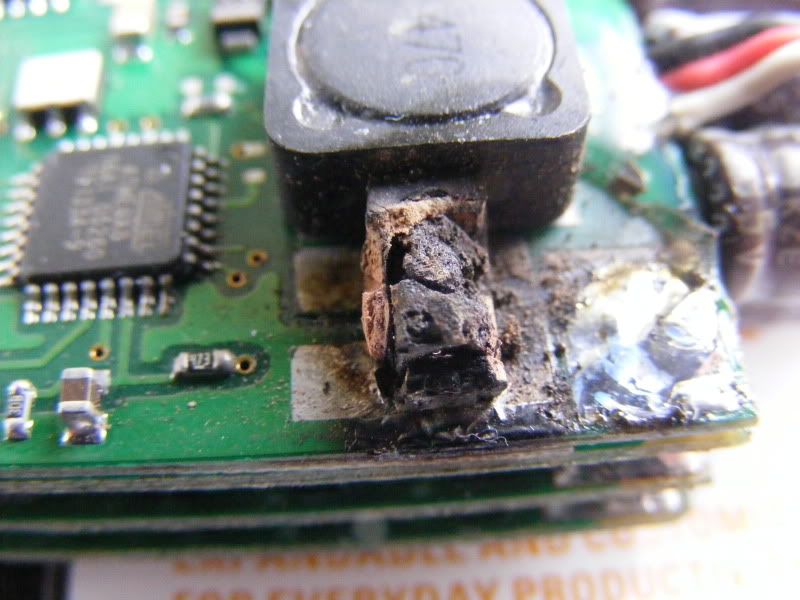

                          I ran my 200 on 8s using the BEC but it blew a component after a couple of minutes, this was in a 36"x14" balsa cat, neu 1521/2.5d 8s1p zippy 30C 5000s on an X646 with a single full size high speed digital servo on the rudder, it had the eagletree in and my highest spikes were 150A, I wasn't measuring servo current, all the FETs are fine and it still works with a seperate UBEC so I think it must be part of the BEC circuit that blew, but running with a partially blown ESC seems like a disaster waiting to happen so I bought another to replace it with the intention of running an UBEC but I noticed that there are two of the components that blew up on the new one so I may just use the on board BEC again, can anyone identify what the yellow components are, confirm that they are in the BEC circuit and whether them being doubled up will improve things.
                          the single blown component in the foreground looks to be the only damage, so if it can be identified I can replace it or upgrade it and get it back in use, if not it will donate it caps as well as its cooled heatsink to the new one.
                          the replacement has 2 of the blown components whatever they are.
