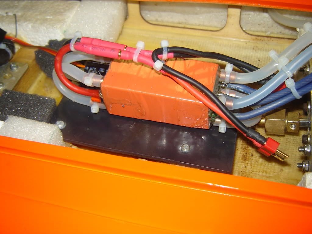

              hey Doby, thanks for the tip!! it worked perfect!! i used some 5 minute epoxy i had (had to work damn fast!) and coated it with it. i was alittle scared at first so i did it to a mamba 25 i had laying around first. after about 2 hours of curing i connected a battery to it and put it underwater.......................end result, homemade waterproofing . thanks again for the tip.
              here's what i did to my BK esc>>>>>>>>>>>>>>>>
