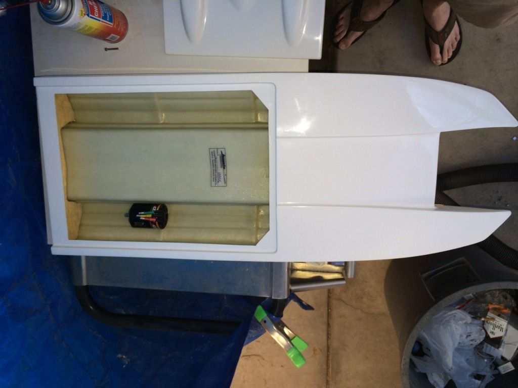

                        For the best cat to run fast and turn awesome I put my money on the Aeromarine Team Believer with updated hatch. It's the 36" Sprintcats half brother. It's a small big boat with tons of room. It will handle 70 with ease all day long. This is the electric version with no rails and has been built light with extra glass in all the right spots, it is a serious cat that is very easy to build because it has tons of room in it. That's a 56mm motor in one of the sponsons. I'm planning on making it a 16000mah 6s sport boat as of now anyway lol
