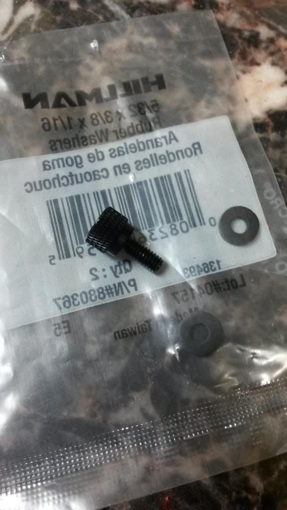

            I use anodized black aluminum ones. Like this with flat rubber washers
                        where do you get the anodized thumbscrews?
                            Ebay
