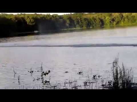

                          Originally posted by iridebikes247
                          Just get a castle 2028. Big, simple, efficient.
                          10s2p you're gunna want 10,000mah. A 2028 can be had for 240$ now and is probably the most economical choice for that boat without sacrificing performance. Kevin Pratt is a member of our forum here with the setup looks good to me.
                          http://www.youtube.com/watch?v=X3Cw-74D_jw
                          Thanks, but that video was just the first test runs, she's come along nicely since then, this one is much better......
                          My private off road rc track
                          https://www.youtube.com/watch?v=XC3H...yaNZNA&index=8
