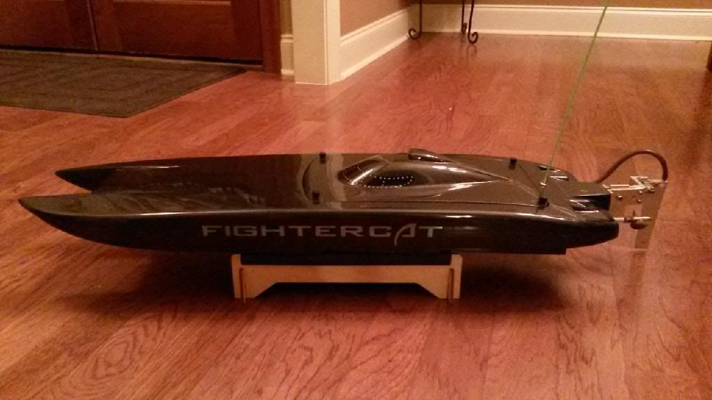

                I have the carbon fiber fightercat version. Castle 2200kv motor. Fightercat 101 esc. X642 s/b prop. I haven't gps it yet but I can tell you it's pretty dang fast. It'll easily walk my cheetah that does 62mph. Here's a couple pics of it.

                        Nice carbon fibre boat kfxguy that's a nice looking hull. I think I might have to secretly buy one with the wife knowing.

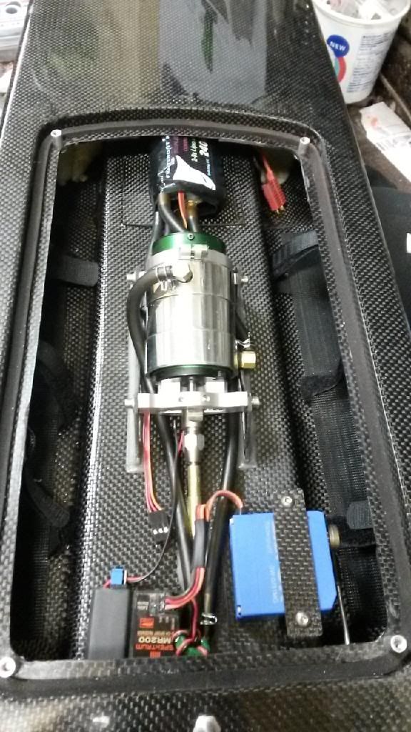

                          I did forget to mention I have made two carbon fibre battery trays and used carbon fibre to hold my stuffing tube in place. this is a photo with my cnc 48mm prop I found that the 48mm gave my a lot more lift but its not worth blowing the flex cable so I will take it off and put the X442.

                            That's a nice clean looking build. I have the same gps, it's turning out to be a great unit. You've got that boat moving right along!
                              You need to rotate the water jacket so the nipples are closer to the top, the position their in at the side your only half filling the jacket with water before it exits. For such little money the SK3 motors are excellent.
