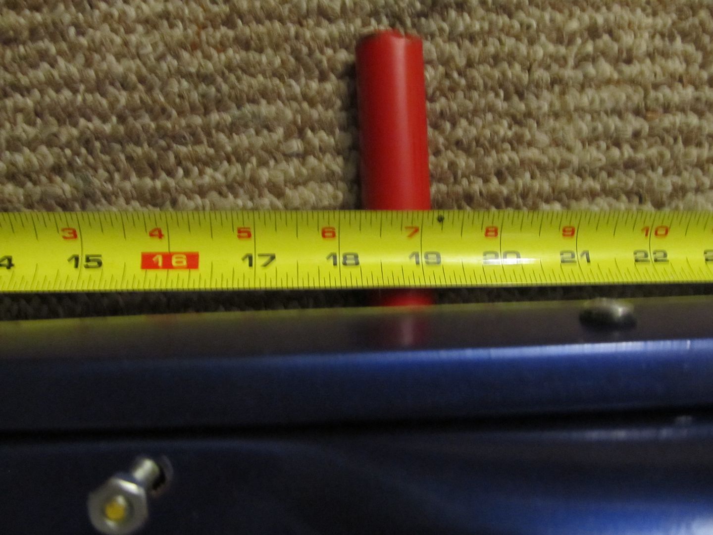

    I got my cooling sleeve in today for my 3674 (2350kv) so I went back to work on it for another go round. Here is how I find my balance point on this hull. Everyone has a little bit different idea on how to do it but this works for me. I just thought some people might find this useful since I don't recall seeing an actual thread on how to balance a hull.

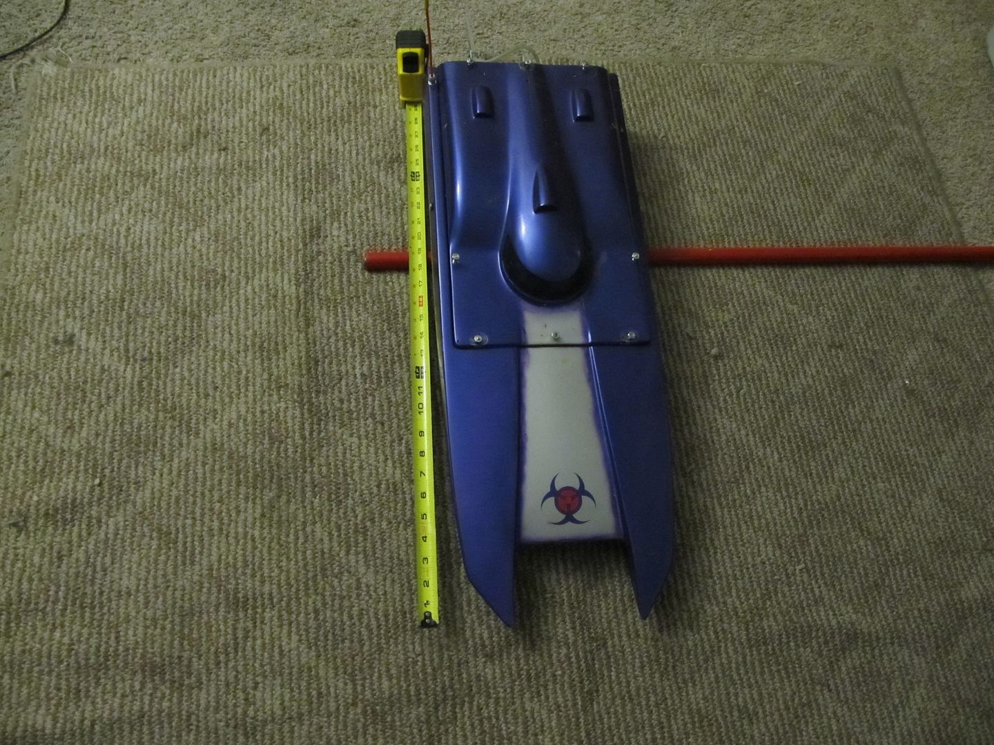

    Start by outfitting your boat just as it would be as if it were in the water with the batteries, floation foam, hatch and everything else in it that you need to run. Then find out where your starting point should be. Then get a wooden dowel or in this case a broomstick and find your balance point as if it were a teeter totter.

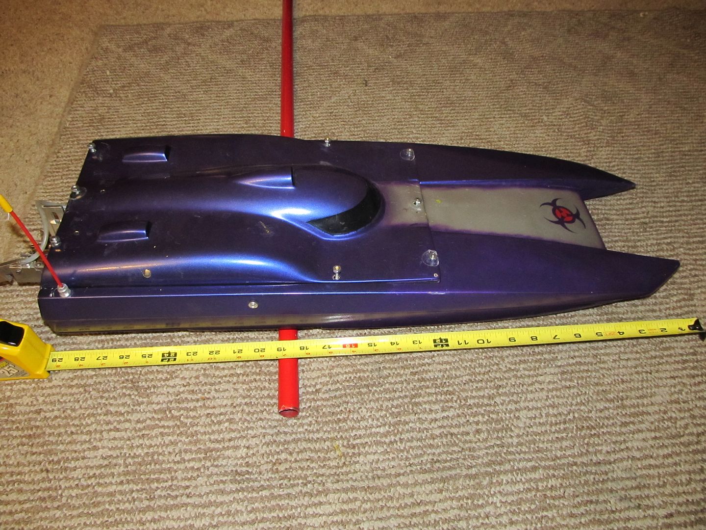

    I use a measuring tape to break this hull up into percentages ie: 25%, 50%, 75% & 100%. In this case this hull is 29" long, so from front to back 25% is 7.25", 50% is 14.50", 75% is 21.75" & 100% is 29".. I can subdivide the percentages from there.
    With this stepped Hull, I want to start with a 70/30 split front to rear, so the balance point is on the last two steps when its on plane. This is pretty close to start with.

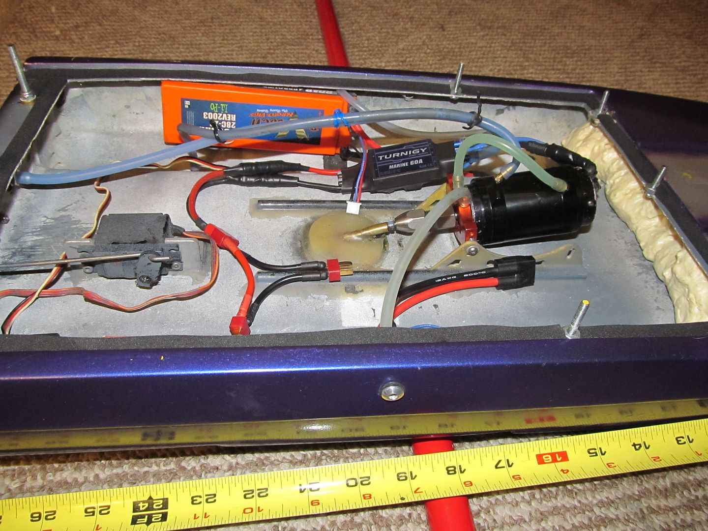

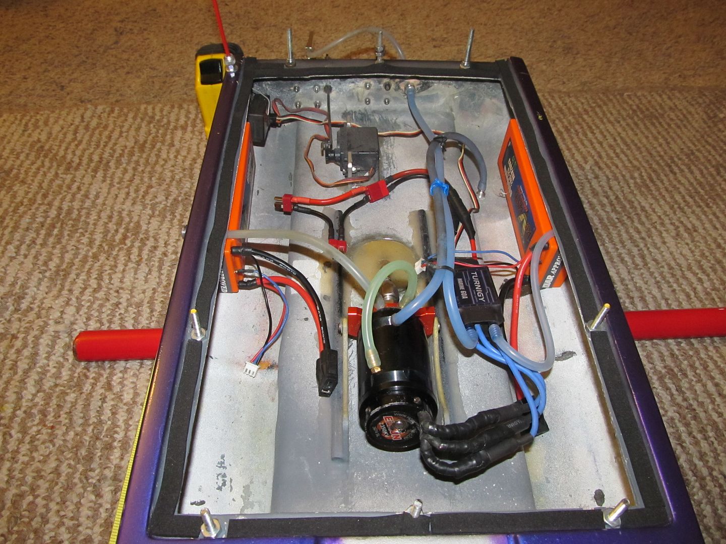

    I pulled the 3656 & bolted in the 3674 (2350kv) and swapped in an m445 prop too. I fixed the rudder and slid the lipos back a few inches. Here's the layout.
    Here's the battery placement if your wondering, from the sponson tip.

    The general rule of thumb is 30% from the rear of the ride pads, which is the same as 30% from the transom in this case. That would be about 10" here.

      The second step is the best place for them.

        30% is a great starting point. i have a meanmachine that i have set with up with everything from nicad to twins to 40/82 brushless and the balance point is always the same. i hope you support that motor before you run. happy easter to you and yours. cool paint b.t.w

            Not balance related but, there are 5 connections from each battery to esc, I would do something to alleviate that issue. You will likely end up with some pretty hot wires and connectors. Also those pacs don't look like they are up to the challenge of supplying that 3674 with adequate power. Just my .02 though, you might not have any issues.

              my mean machine balances perfect at 30%, its like 9,75 inches or so. and it runs great, turns on a dime and gives 9 cents change. no risk of blow over and takes chop dead flat. your motor mount appears to only have 2 bolts holding it in place, that is worrying to me
              **edit** my packs sit almost at the transom. your balance point looks like its 18 incehs forward, this is way to far forward and will be very wet
                  Good catch bro . It's a 60A ESC; but the motor to ESC is 5.5mm, the ESC to series connector is also 5.5mm connectors. The only deans plugs is the series connector itself. Its just a sportboat, but I have an anchor for the front of the motor & some 40c packs for it. I posted this real early this morning b4 bed, I was too pooped to set them up too......

                    Alright, I soldered up a series connector on 10awg lead with 5.5mm connector's, so I can run my thunder power 3850!mah 4s cells.
                    I also rebalanced it on the second step @ 9.75" w/ the 4s cells.
