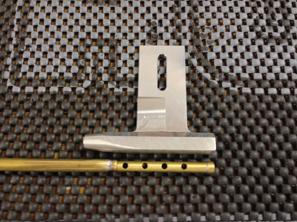

    The Speedmaster sport 20 strut and a 1/4" stuffing tube seem to be a commonly used setup. So I just wanted to show this little problem I ran into. I haven't seen this mentioned anywhere, but maybe I've just missed it... The 1/4 tube fits nice and snug in the strut, but the bushing slides right into the tube and "basically" out the strut. To stop the bushing from sliding into the tube I soldered a short piece of 7/32 tubing on the end.

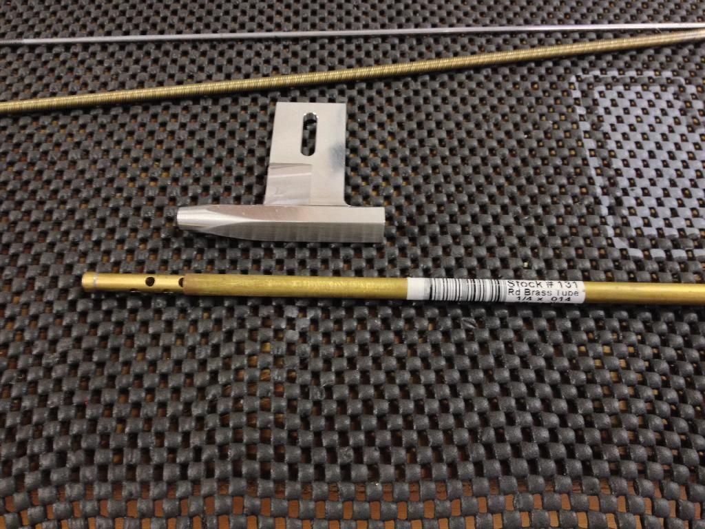

    As designed and intended to be used the 1/4" tube is supposed to go through the speedmaster strut. The bushing then goes inside of the 1/4" tube.
    See these picks (although this is for 1/4" flex, the concept is still the same for a 3/16" flex)

      Yes SloHD. I'm afraid you have missed it.
      The 1/4" tube should fit all the way through the strut to within about 3/16" from the rear of the strut.
      The bush then fits inside the 1/4" strut & should spin freely with the 3/16" drive shaft spinning freely inside the bush too.
      I personally like to cut a short piece of 1/4 tube & fit it into the strut but about 1/4" shorter at the front. The stuffing tube then only goes into the strut about 1/4". Not all the way through. That makes it easier to adjust the angle of the strut.

        Ah ok I see. I guess I was wrong. Thanks.
        785boats- I think I will do that method. Thanks!

          That's exactly how I do it. These struts are apparently designed for IC power, square-end flexes, and take the prop thrust at the collar end of the bushing as opposed to the stinger struts which use the flanged-end bushing which isn't designed to take the prop thrust.

            I did that as well, thinking one can get a little angle adjustment out of this set up.
