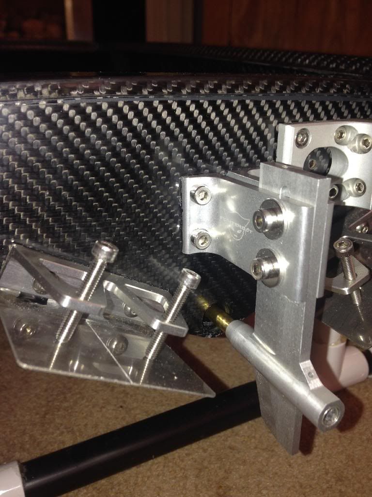

          Not a great picture but here's how my setup it going to look
            Looks good, but completely irrelevent to the OP's question.........He's asking about a stinger.
