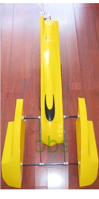

                Quick question on this hull, off topic, But would there be anything positive (speed related) on cutting the carbon rods, and pulling the sponsons closer to the hull, taking the overall width of this hull down?
                LMT

                • nate
                  • 1652
                  I photoshopped this to give an idea...
                  LMT
                  LehnerMotorenTechnik.com
                  • kacordy
                    • Oct 2012
                    • 410
                    Nate, You will not gain speed, reduce drag etc. by cutting the booms and making the footprint narrower. Im running 15 inches between the sponsons. The width gives the boat stability and the reason riggers turn flat at WOT. Someone might be able to chime in about a formula to determine the proper width, a length/width formula etc. to determine a starting point for width. I followed the recommended specs from H&M. Your footprint Question will most likely be a very small consideration in performance and speed. The motor, ESC, prop, strut set-up, batteries, ESC timing will be the key elements to getting the optimum, not the fastest, but the most desirable "safe" "reliable" "enjoyable" performance out of your complete FE package.
                    Allen
                    • FCM Racing
                      • Jun 2013
                      • 14
                      Formula for sponson distence most hulls use a 2-to-1 setup, i.e., for every inch between the sponsons, there are 2 inches from the rear of the sponsons to the transom . so if you have a 28 inch afterplane you sponsons should have 14 inch spacing more is better
                      Gary
                      • nate
                        • 1652
                        So im guessing the positve here, less distance between the sponsons, equals more strength?
                        LMT
                        • FCM Racing
                          • Jun 2013
                          • 14
                          Run them at 15 inch they will be stong enough and the boat will be more stable I run gas as well and they are at 18 on a gas rigger
                          Gary
