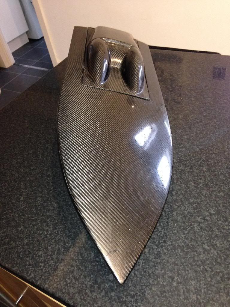

            picked the hull up today and cant wait to get started on it
            what power setup is recommended? I don't want overpower it and 6s sport running is purely my goal here so nothing over 50mph, I was thinking of a 1400kv leopard 4074?

              That motor is a bit small for the hull size. I'd get at least a 84mm long motor with a Kv between 1300 and 1400 - longer is better. No need to spin it too tight, that Kv will handle several props which will get you to 50 .

                Thanks Fluid, it is quite a big hull so I think you're right but cant find any 4082 in the UK under 1600kv although I can get a 1400kv with the smaller can, may have to ship from elsewhere, I have a spare M445 so was hoping to use that.
                I will start a separate build thread once all the parts arrive and will got for a flooded stuffing tube/strut arrangement

                  I think a better choice would be a Leopard 4092 over the 4082, I know their not that easy to get in the UK but Allan @ Astec has the 4092 - 1300kv in stock. OSE also has a great selection of kv for the 4092 motor @ a pretty good price complete with free water jacket, I may have been lucky when I bought my 4092 - 1390kv with water jacket for £94 from OSE, this included shipping cost & I had the motor in a week to the UK & didn't get charged customs.

                    I've managed to find some TP 4060 (4092) in various kv's in the UK at reasonable prices but will speak to Allan but was pretty sure they were around £110 plus postage?

                      Yes they are £110 + jacket + postage, when I bought mine I think it totalled about £132 if I got it from the UK. The other reason I ended up getting it from OSE as they had more choice on the kv I wanted which I couldn't get in the UK + it was a bonus getting it all for £94.
