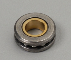

What parts and what is the install sequence? I assume the TB goes between the coupler and the face of the motor mount?? I am just getting ready to install a TB as soon as OFE delivery comes. I was installing a tran in my Titan 29 but decided to go direct drive. Thanks
Sdarrt, trust me you need one, talk to Steve from OSE or any EXPERIENCED boater her and they will tell you to install one, and don't allow anyone to convince you that boats are the SAME as anythig else and that you don't need one. I have had and still have loats of RC cars and they don't need one. So I'm not going to tell you that you don't need one cause my RC car does not need one, that's silly. It's a small investment and does not hurt anything at all, if anything helps if you understand mechanics.
SDartt, there are two kinds, one piece and three piece.
The three piece are installed by order: Washer, ball ring bearing, washer. See pic below.
Not having seen a thrust bearing in place (but understanding the concepts) I fail to see how the loads are being transferred to it ??
thanks
Ghost
edit: SWeet accord posted his pic as I was posting but I see something that would disallow any rearward movement but isn't pulling on the front of the shaft towards the transom the real problem or does the shaft want to push the back of the can out of place for some reason ??
