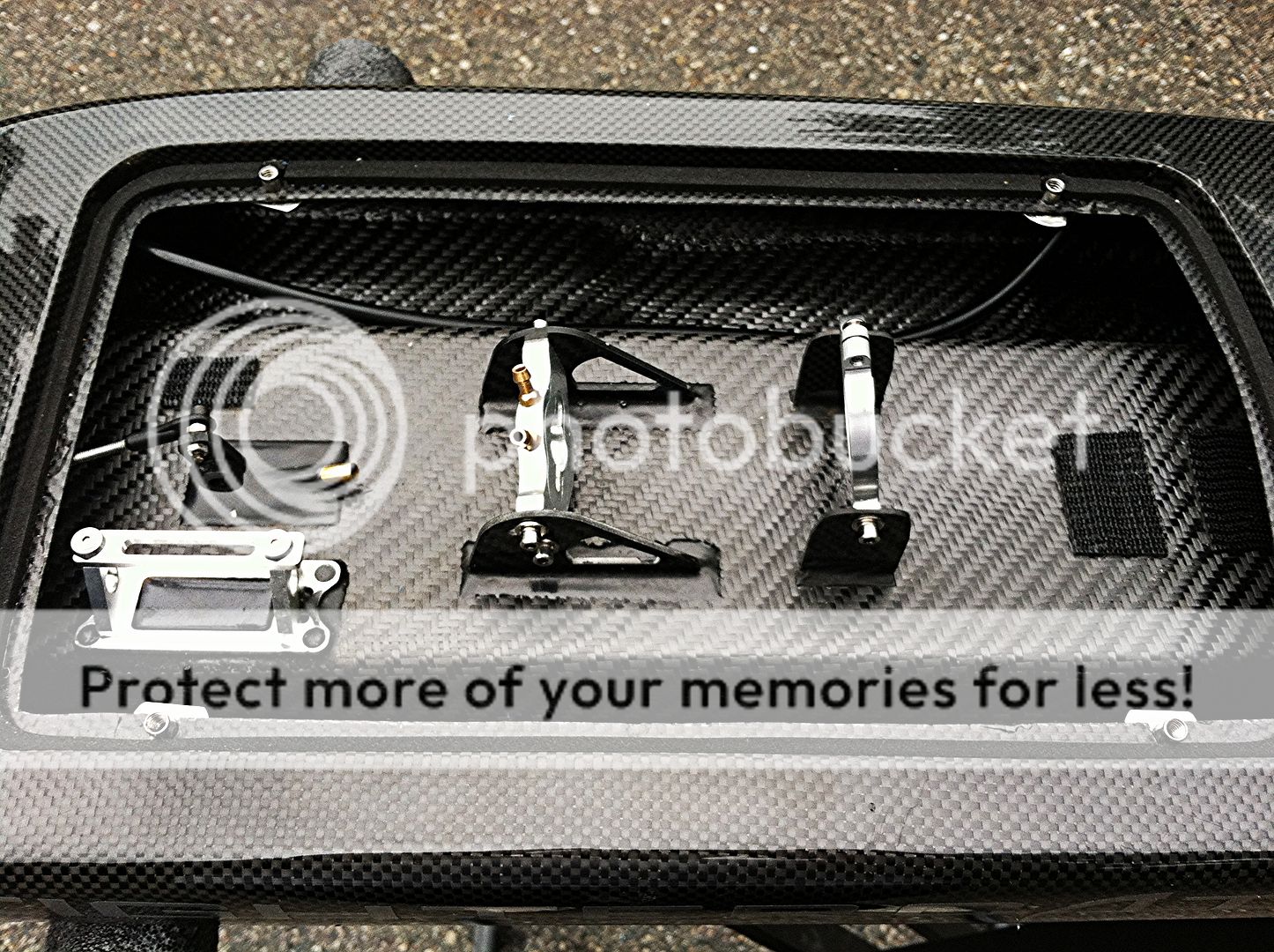

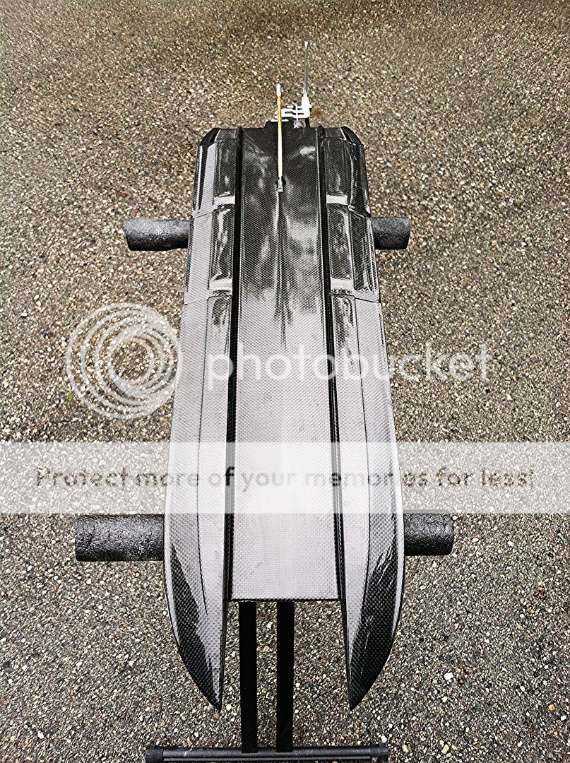

                        Originally posted by kfxguy
                        I looked through your pics btw and didn't see how you ran the drive for the single. If you have any pics of that and couple post them, it would be greatly appreciated!
                        Here are two that I built as singles. A carbon fiber and a fiberglass hull.

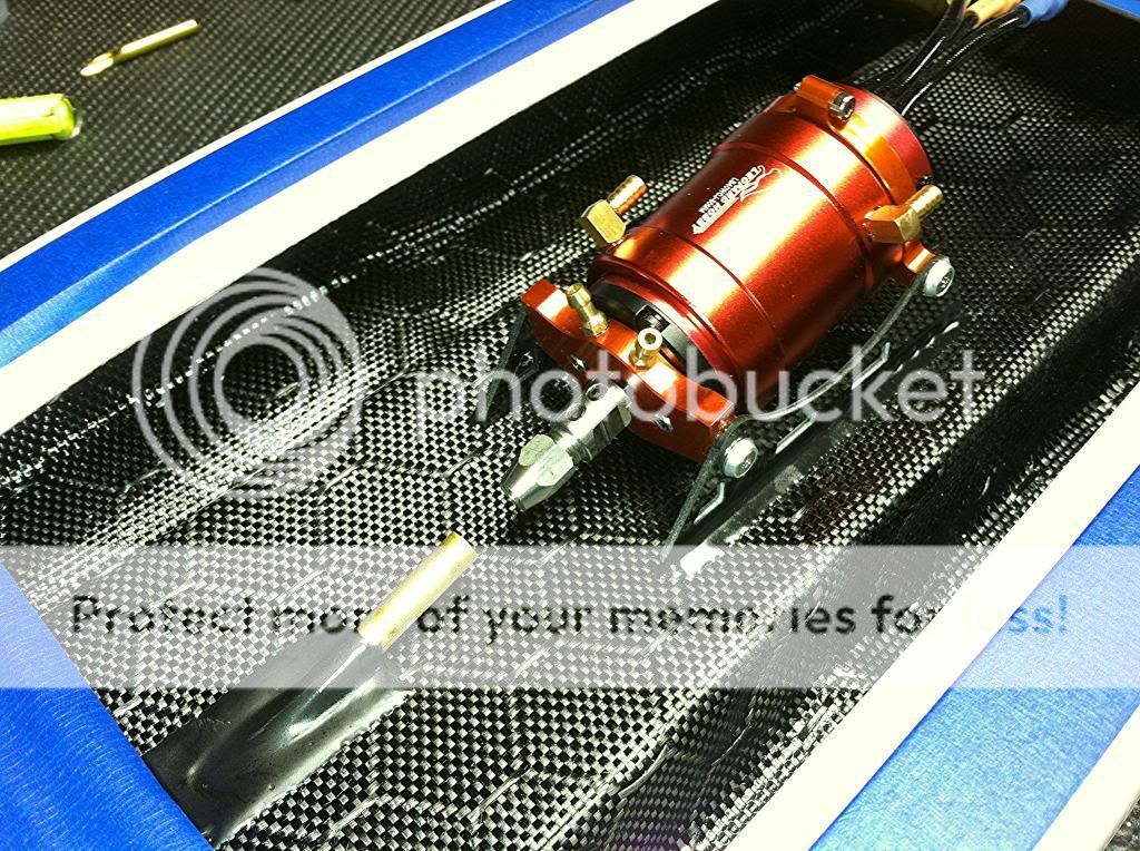

                          Here are a few pics of my boat.

                            Awesome. Thx. Question. How is it built up around shaft on the bottom side? In the pics I've seen on a bare hull, its flat when you get it new.
                              Also, the hump in the middle....are you forming that over a 2x4 board? Sorry for all the questions. Im new to this but im pretty handy. I have a vacuum bagging carbon fiber setup and a mill/lathe so I can do quite a few things. I just need some ideas on how you guys are doing it. I just want it to be right.
