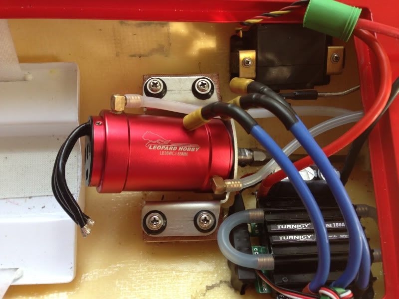

    Purchased a leopard 3674 from kevinpratt823 on here. Got the motor in, matched up to a turnigy/seaking 180a I had laying around. 6.5 bullets going on the motor, castle 6.5 connectors on the battery. My fastest so far with the stock revolt with an x445 was 46mph. I'd love to see 50mph out of the leopard setup. Going to spin a m445 first and check temps. Have a package coming from ose with parts for dual water cooling, carbon fiber battery tray and m545 & m645 props.

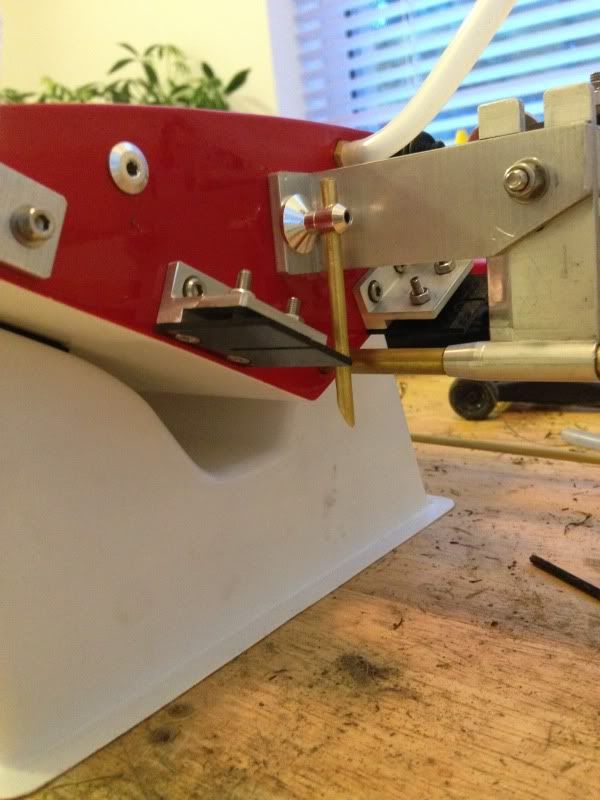

                        Got parts in for dual water cooling, ose transom pickup. The brass tube it came with wasn't big long enough so I made my own. Trying to decide where I want to put the outlets. The outlet in the picture is going to become a thru hull bulkhead inlet.

                          Sir, the way I make pickups is to anneal the brass tube in a 90 degree rounded by heat and will have less drag. My ? is the strut brass? You could anneal brass in a J formation and solder to brass strut and have pickup just under transom , plus less drag than in photo. The present setup is 50% more drag than what I suggested. The J piece will look like J. Just a suggestion!

                            I'm not understanding what you're saying. Maybe it's the angle of the picture but just the tip of the brass pickup tube is below the transom.

                              http://forums.offshoreelectrics.com/...ickup-location. Look at the pictures in POST #2 & #3, especially #3, some solder a brass tube on their strut, provided you can do it with aluminum, there is no brass strut that I am aware of.
                              The ones in the pictures are what the so-called prop-wash water pick up. They don't "extend" into the water, hence less drag.
