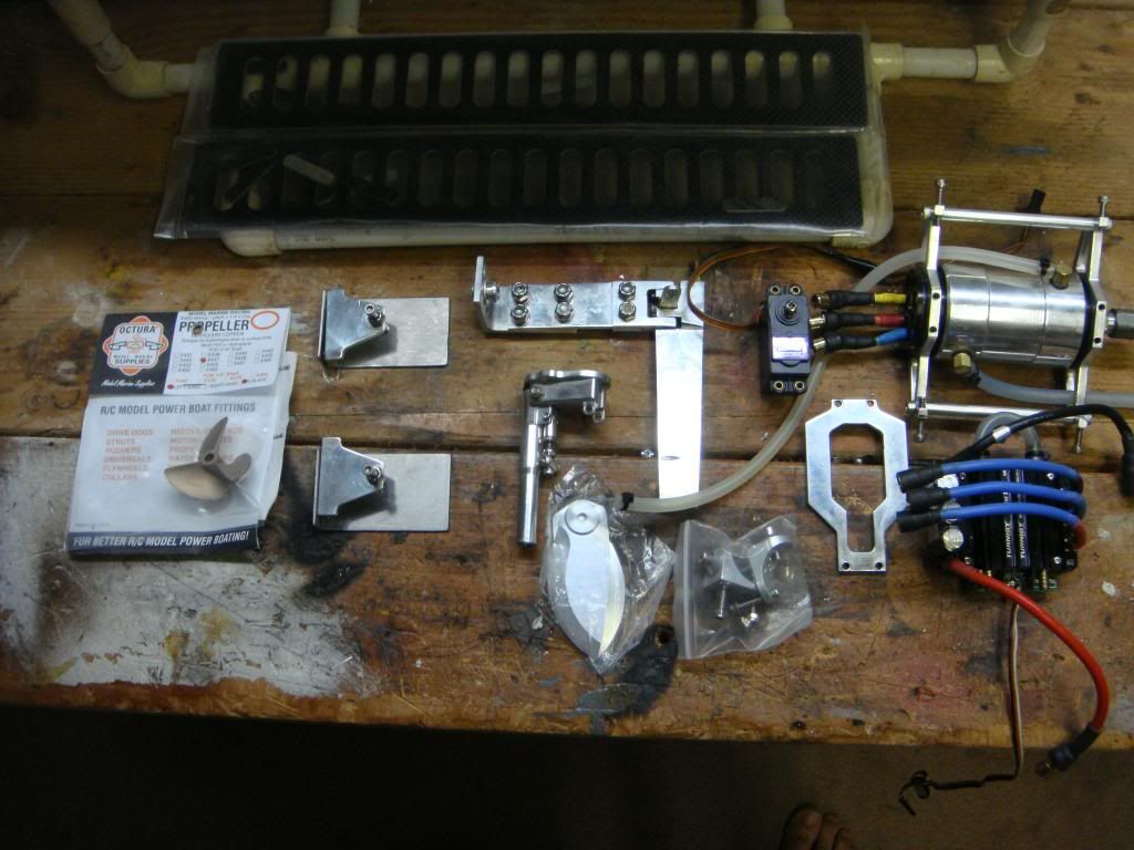

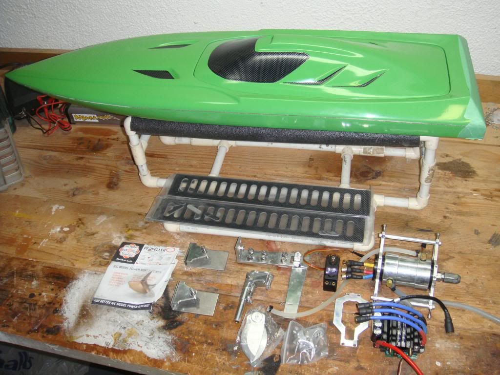

                  power is a neu 1521 1.5d... prop will be an x447/3 then maybe an x450 if things go well..pics on the way

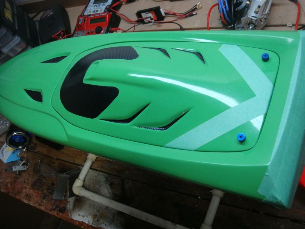

                            the tape on the stinger is the cutoff point for better handling fyi, and I used associated blue thumbscrews on the rear hatch with stainless studs underneath and rubber grommets on top of hatch so no scratches. Hardware is 100 percent speedmaster and fins are ose large size.
