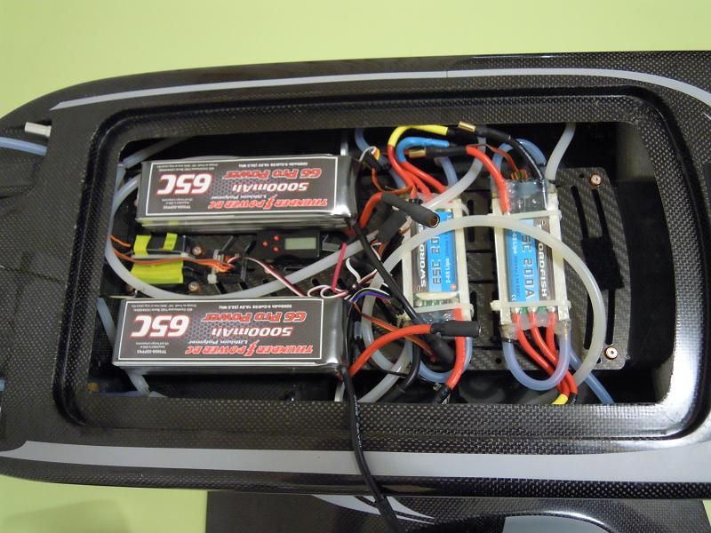

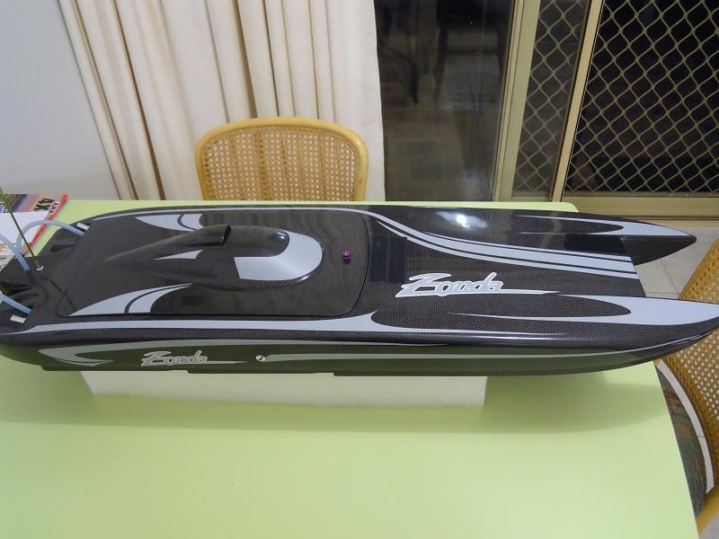

        Got the CF Zonda. Yes the hull is very thin and it's a bit disconcerting being able to see a whole lot of daylight through it. My hull leaked like a sieve when I first got it and I had to seal over all the through-hull bolts and screws. Trouble is - it is extremely difficult to reach the rear of the boat from inside with any tools etc etc. Ended up having to pipe some glue in and just let it set over the mounts for the stinger angle adjusters. Running the black can 2075kv motors that come with the hull in the ARTR version. Run 2 x 5S Thunder power 5000mah batts, but I had to cut spaces for them from the internal mounting tray. Once you do that though the 5000mah's fit without issue.
        Honestly I'd get the hull only and put decent motors inside. So far I have topped out at 90km/h - and that was with slightly oversized props that had me heating things up real fast.
        Will not turn at speed with the stock rudder. Looking to fit a larger dual pickup to mine.
        Anyone can give me a way of setting this boat up to go faster and I'm listening.
        Good hull though. Definitely will handle more speed than I've been able to get into it.

                            Just had to trim the tray to get the servo in on mine, cut out a section for the batteries otherwise they sat to high
