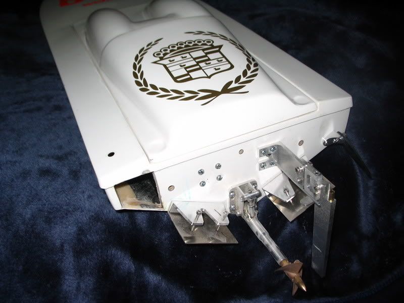

    Hey guys. This is my new fun boat. it is a " E2 mono" really but wont be raced as E2.
    at my condo, the water..... it is very rough and can have alot of wind. so i needed a large hull, heavy, and can self right. not to mention one that handles well.
    The toys port triton was nice but i could not handle worth a *!***!***!***!**. after i sold that, i ordered a seaducer SD3, after taking FOREVER to get here i canceled that ( would have been my E2/fun boat in one).
    so i got this titan 40., heavy big and.....

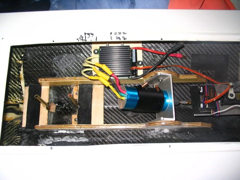

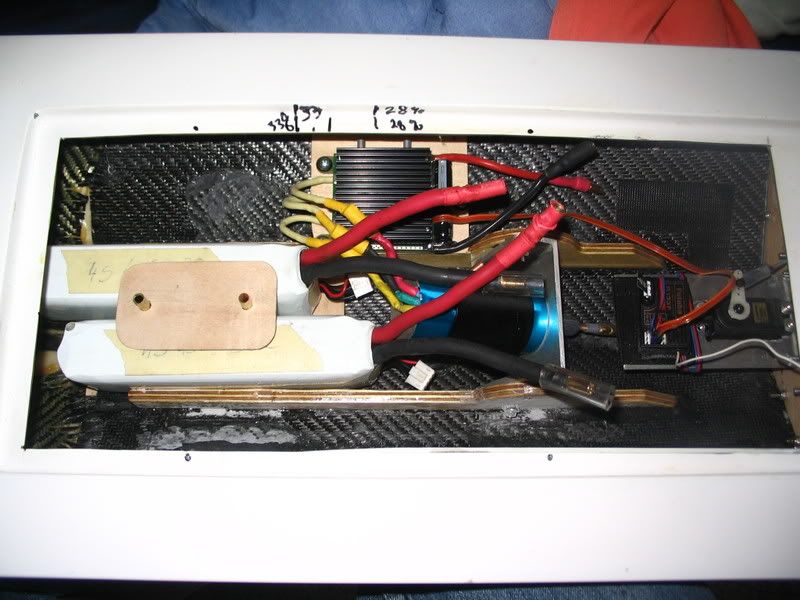

    SO i chopped a hole in the back and threw in a 12XL, hacker 77 and 30C4500 Mah 4s2p packs.
    slow, well yeah but good enough for the wavy conditions i see at my condo but still fast enough to patrol the waters on goose watch.

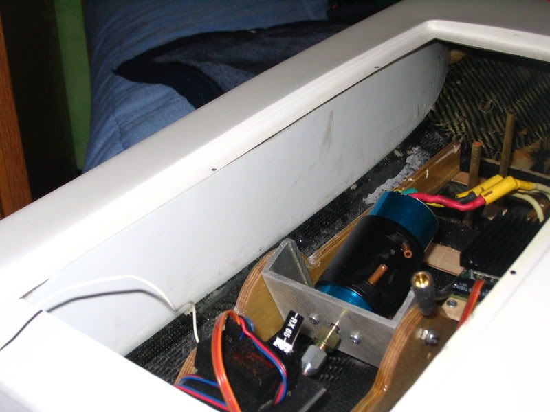

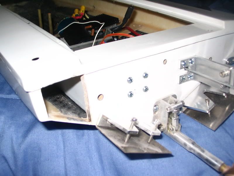

    now with a water chamber ( works flawlessly) and my packs down the center line, they are not going no were!

    Very nice! I just bought a titan 29 and a titan 33 hull for a future build. These hulls are well built and seem to handle very well in rougher waters. Actually, the thought of making a flood chamber on the titan 29 crossed my mind. It's great to see that some one has actually done it! Did you make a small pinhole toward the bow on the side of the flood chamber?

      not a pin hole, about the size of a 1/4 of a inch. and i made 4 of them.
      the titans do not handel FAST well. 50 + and they down right suck. but they are good in rough water.

        Where did you place the 4 holes? When you get a chance, it would be great to see the flood chamber in action. As for me, I bought the titan 29 to use up some spare HW I had lying around.
