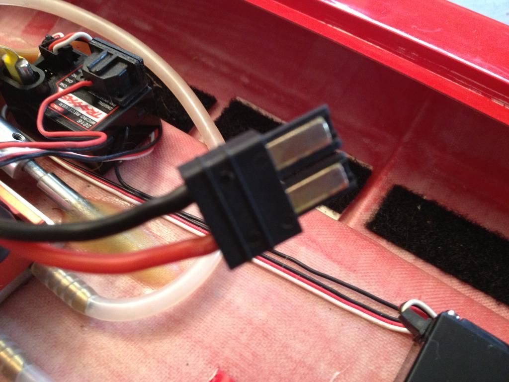

    Could somebody take a look at these pictures and try and help me figure out how to get this thing to work? I have zero knowledge...
    Here's a pic:
    Also, what does this connect to:
    Does it need batteries? Maybe there are already batteries?
    Thanks in advance for any help!

    yes you must have a battery pack the bottom pic is your battery plug it most likely takes 2 packs from the look in the first pic

      thanks! Any idea what specific batteries?

        i would use at least 5000mah 40c lipo packs you need to know your esc specs to see what the max voltage will be to know if you need 2 packs or just 1

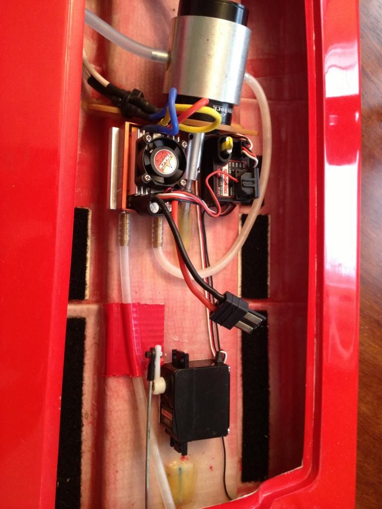

              Somewhere on the motor it should tell you the KV, without knowing what rpm the motor is capable of turning it's impossible to tell what batteries it should run.
              What boat is it? Size?
              Choosing the wrong voltage to run it at could make short work of the electronics if you choose to high a voltage, too low and it will be slow.
              ESC is not what determines the batteries you need, that is all to do with motor KV, just because the esc lists a max does not mean by a long shot this is what you SHOULD use. Once you've determined the voltage of the batteries the esc determines the maximum prop size you can run and this is usually found through some trial and error. Although you can get a rough idea of this by the size of the motor.
              You want an unloaded rpm of about 30 000 rpm ballpark, divide this by the KV number from the motor and this should give you roughly the voltage you need, It won't work out to be an exactly available battery voltage of course so you choose the battery voltage that is closest.
              If the motor is say 2000kv you would run it on 4s or 14.8v, 4000kv would be 2s or 7.4v.
              The size of the boat and motor determine battery capacity in Mah. Too big a battery will effect the handling of a small boat, too small a battery you will have shorter runtimes and possibly overheating problems as smaller batteries would have to work harder to supply the current.

                I have two of these, they are my favorites. The stock TENSHOCK motor is rated at 2000kv if I am not mistaken. You need 4s. Get two of these:http://www.hobbypartz.com/77p-sl5000-2s1p-40c-2222.html or something similar.
                Now, I don't know who did the set up on your boat, the ESC is obviously a modified one from cars/trucks, do you know the rating on that? I will not feel comfortable running that ESC, also look at how skinny the motor- to- ESC wire extentions are, you are asking for trouble for the kind of typical high amp draw which you will encounter in a boat application. I used this :http://www.offshoreelectrics.com/pro...er-seaking-120 and it's been bullet proof in the Samurai.
                In anycase, with only a single Traxxas plug, you still need a series adapter to connect to two 7.4v lipo batteries. To many extra items in your electrical system = resistance=heat.
                I sure hope you can enjoy this boat. Also check the epoxy on the motor mount, sometimes you need to wiggle it a bit to see if it is loose, factory epoxy tend to turn yellowish and becomes brittle.
                Make sure your servo is secured, I seem to remember that there shoud be an aluminum servo mount. Looks like it is double taped now, do something before the servo falls off and you may loose control of the boat.
