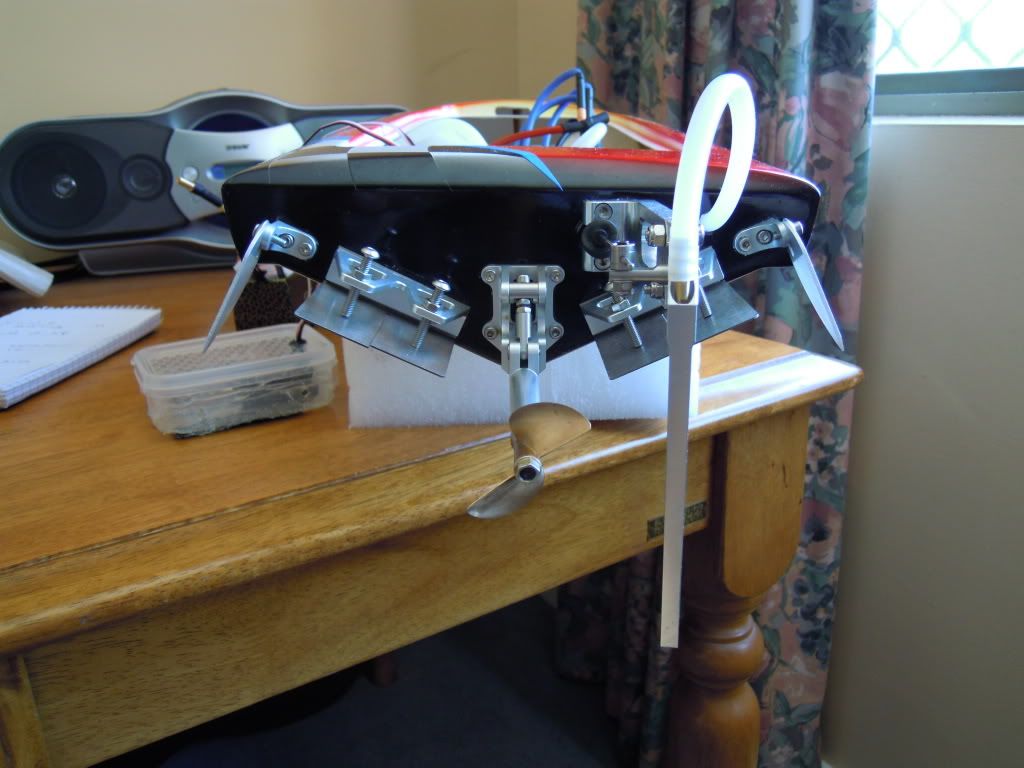

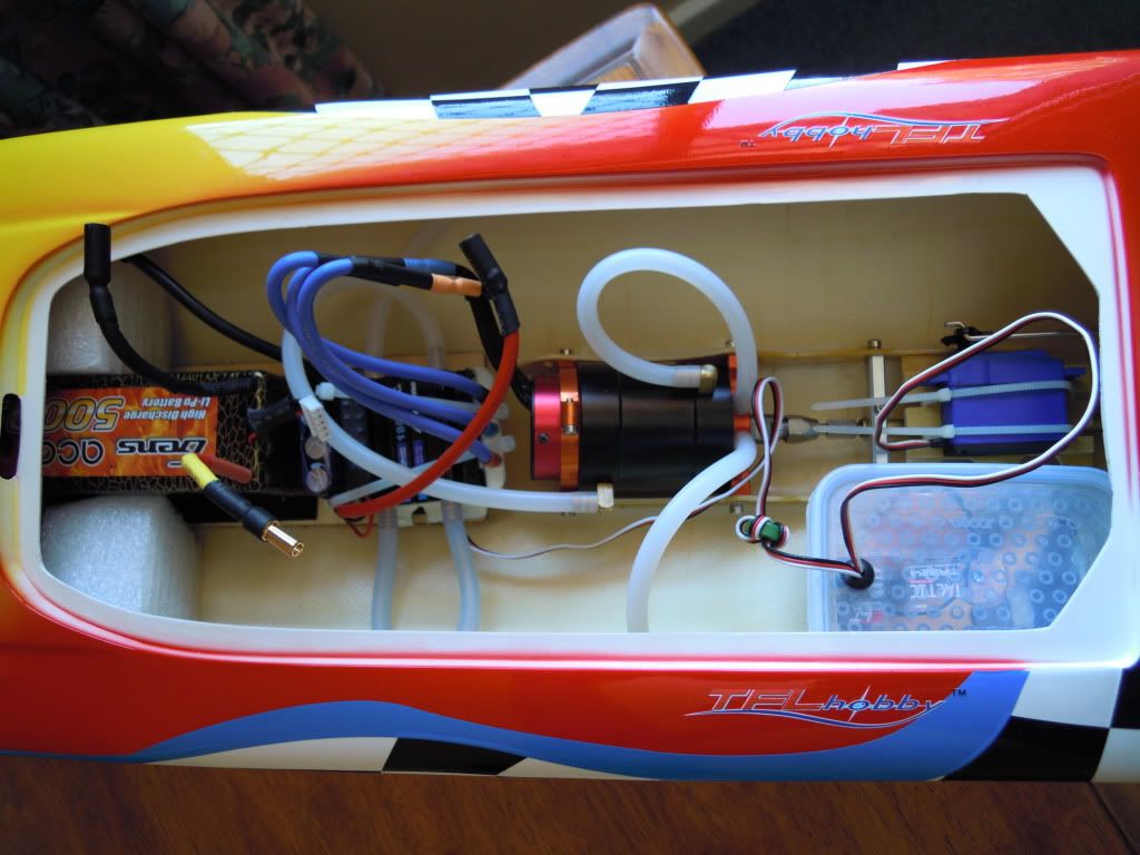

    So I ran the boat with a Gens Ace 4S1P 5000Mah 40C LiPo and promptly melted the stock Deans connector. So - now 5.5mm bullets replace that. But, I still have the 4mm bullet connectors on the motor. They do get hottish, nothing drastic so far but certainly on their way there. What I've been experimenting with (on other boats) is using some heat glue, Arctic Silver Epoxy for instance, to glue the wiring to a water cooling block. But I'm not keen to put any more constrictions into the current single water line in the boat, so I want to put in a second line for the water block.
    I was hoping someone else had already installed a transom mounted water pickup and could show me where they put it and exactly which pickup to order. I have several transom pickups here but none will fit, unless I glue them on which I'd rather not do. Any suggestions??

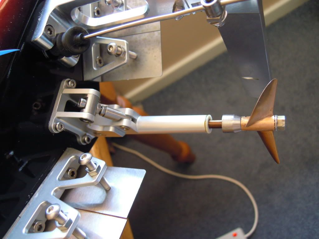

    I think I have the wrong Flex shaft for the boat. See how far the drive dog is from the end of the strut? Is that sticking out too far??

    I have seen guy's mount them on there Trim Tab's before and have them so they are about an 1/8th below the Trim Tab.
    If you want a Transom Mounted one you could get one from a Hobby Dealer if you have any that carry AquaCraft and get a Mount and Tube for a Montely Crew or get one from OSE they have a really nice one.

      You mean mount the pickup on the trimtab itself? I suppose you could drill a hole through the trim tab big enough to fit the brass tube, then somehow use the tab adjusting assembly for extra support...... Anyone done that?? Seems plausible......
      On the other hand.... does anyone know of a dual pickup rudder that will go on the pursuits??

          I did think about the under-hull option but I'm really not keen to go cutting holes in the hull - just don't trust myself. Think I might be able to get away with mounting a transom pickup between the trim tabs, and drill a hole through the tabs for the pickup to go through........... Looks like it might work...... Well..... That's the theory.........

              Yes tlandauer you may well be right. I was hoping someone with the same boat & setup could offer comment. So....... If you have the 4082 motor and run 4s with the 5.5's on the esc -> motor wires without issue then I might try that first as well. Just that while the connectors do get the hottest, the actual wiring also gets hottish as well. Test the 5.5's and see I suppose. Just seems odd putting huge connectors like that on such small wiring. The pickup would create extra drag there's no doubt, but I suppose it's a cost vs benefit situation.

                  Really, the 5.5 bullets are just extra heat sink when it comes down to it right? They aren't going to make the wiring harness run cooler as such are they? Just that with them installed the wiring needs to get a whole lot hotter before you get a de solder.....right? Or am I thinking that through wrongly......? So if there's heat building up in that wiring now, the simple addition of the 5.5's isn't going to get rid of that heat.......... Just help manage it.
                  In any case the 5.5's are an easy install so I guess it's the first thing to try - along with tweaking the attitude of the boat in the water.
