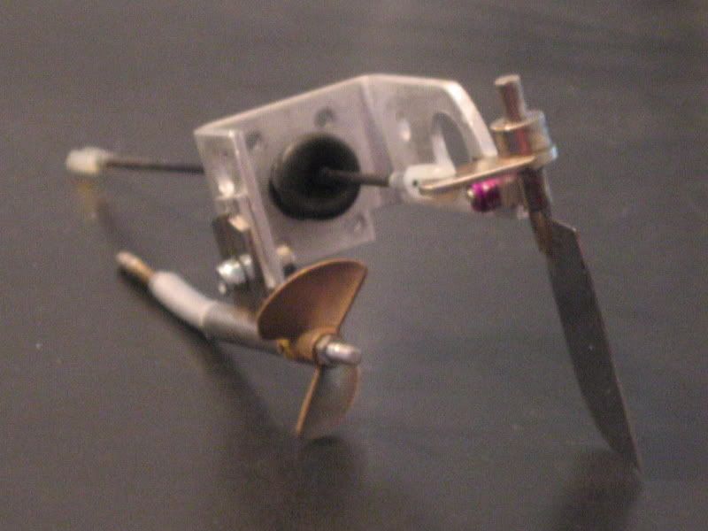

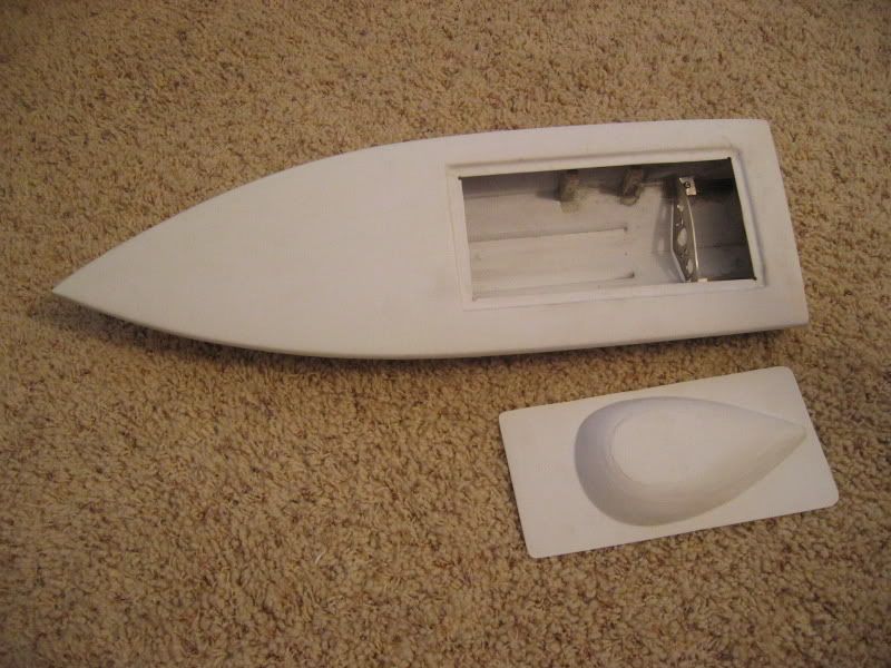

    hi.. i am new to this forum and new to boats..but i am a pro at rc cars and truck.. i have bought a bby oval racer hull like last year.. the only thing i have done to it is i painted it, and put new hardware in it.. this is how i got it-
    then i got the hardware

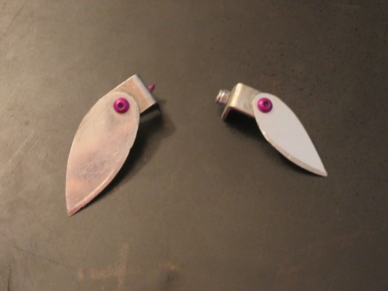

    some parts i custom made-
